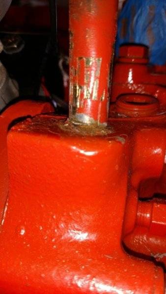

Speaking of which, do you remember this mess I inherited with the current 440 in my GTX?
Some previous knotheads' idea of hooking up a heater hose in the wrong outlet was to insert a smaller
threaded nipple in there, then literally glue the larger nipple on top of it.
THAT was a lot of fun to try and get out of there...
I did wind up using the smaller outlet for one of the heater hoses, though - I needed the larger one up top
for my temperature sensor probe thingy for the aftermarket gauge.

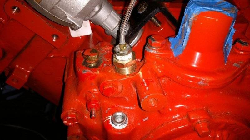

The two plugged holes in this pic are where the hoses wound up being connected (note factory idiot light
sensor still in place in lower left):
Just an update...because it annoys me when I give advice and never hear how it turned out!
I was out looking at the car and am happy to report: The hoses are connected correctly. I will replace them when the new HVAC system goes in but at least I know that I had it right the first time.

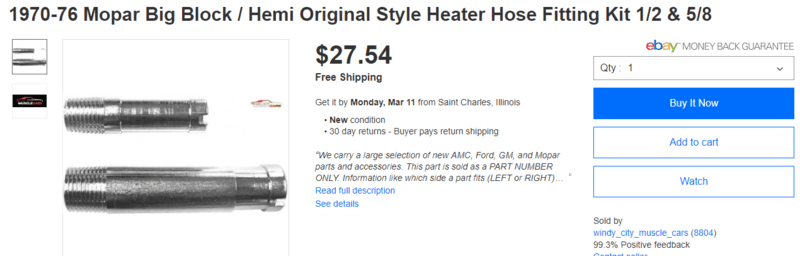

I know very little about either the factory system or the aftermarket stuff. I have noticed that occasionally, there would be coolant dripping inside the car. Because of that, I decided to temporarily bypass the heater core and just loop the two hose nipple connections together. That fitting closest to the alternator bracket is a pisser. I went for a drive earlier and had to cut it short when the temps got too hot. I did a crappy job tightening the hose clamp. I guess I do need those hose nipples suggested by member 1972GY8SE.
1/2 and 5/8 on big block Mopar. Your going to need these. did mine recently.
