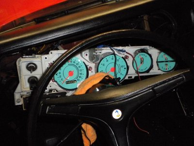

Hi...I had the same problem with my 73 RR...went ahead and replaced the foot switch which was pretty easy to do...BUT,no joy...hummm I thought...well it was time to do some dash work...replace all the bulbs with LED and sure enough when I finally got to the hi-beam bulb it was burned out...it was hard for me to reach this area with my arm,although all the time the guys say they do it...but for me it is hard to reach those upper dash areas from laying on the floor and the way this particular bulb is situated it was hard for me to even locate it let alone replace it...Marla...:icon_hang:
