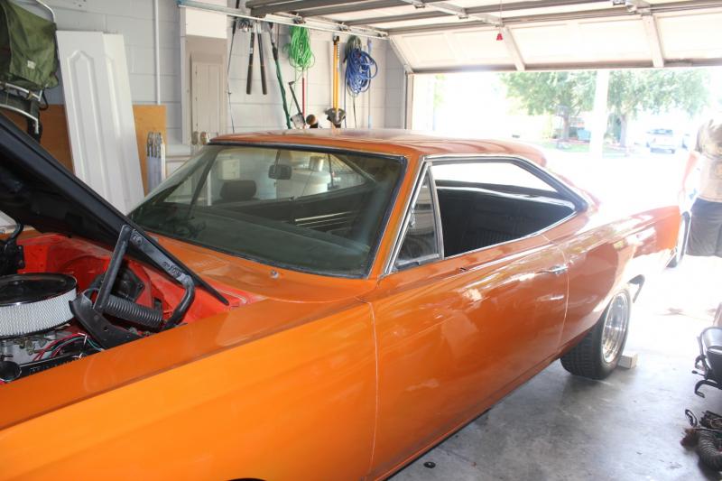

Here is an old pic from when I first started on the car... hadn't even got the chrome on it...she's come a long way, but still lot's to do. As soon as I resolve some of the motor issues, I'll pull her out into the sunlight and post some better pics.
