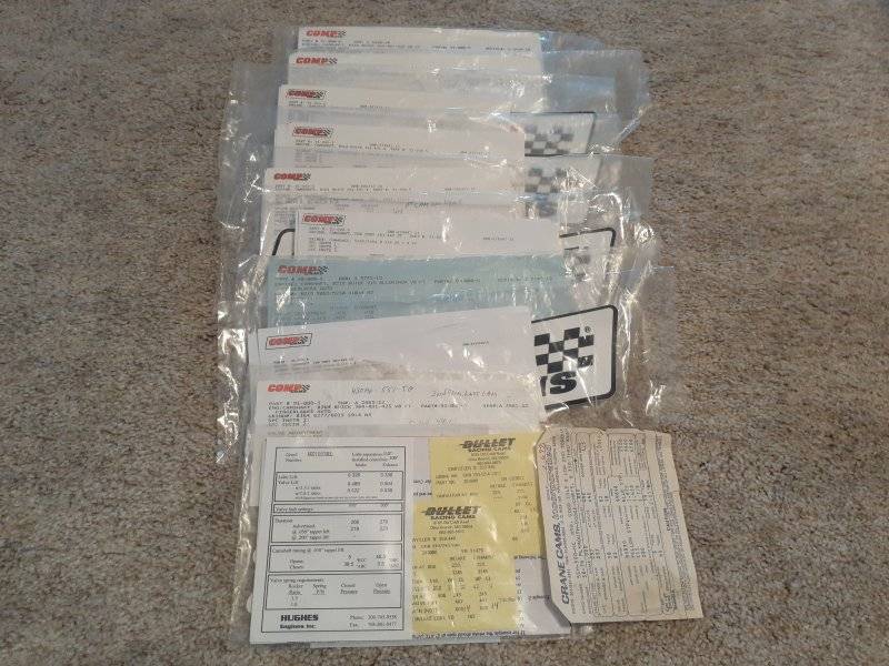

Hughes cams are not as fast ramp as comp cams. Hughes cams have a very high lift to duration that is why I shy away from 1.6 rockers. comp cams have a very narrow spread between duration @ .050 and advertise duration more narrow than the Hughes cams. I ran a lot of both cams and Mopar cams over the years. Hughes cams seem to have a nice power curve all the way to high RPM. A similar Comp cams have faster ramps that will turn on faster at lower rpms, little better vacuum and idle and make more peaker TQ and HP and not as much at the very high RPMS. as best I can explain it. as you can see in the photo I prefer Comp. I am missing all 4 of the different Mopar cam cards and 3 Hughes cam cards because I never saved them back then.
