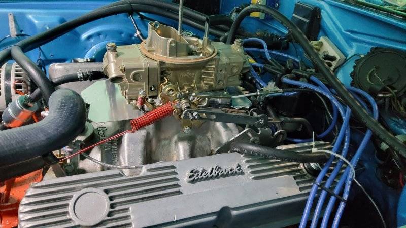

OK I got my throttle cable mod almost done,was very easy to do,I have a few tweaks to do and them paint.used my low rise throttle bracket no need to get any thing else.it can be done for very little money.
looks good! can’t really tell by the pic but it looks as if it may be a little high. it needs to be a bit lower than the cable attachment point at the throttle lever at wide open.
That is the 1 thing to tweak it needs to be lower just a tad.
