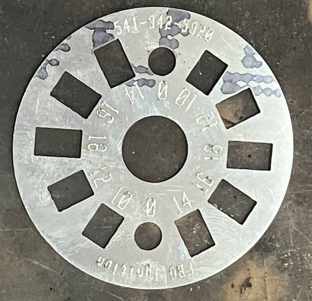

I limited the total advance with this:
FBO ignition sells them. I have mine in the "14" slots but I got 15 degrees of advance. That is close enough for me,
