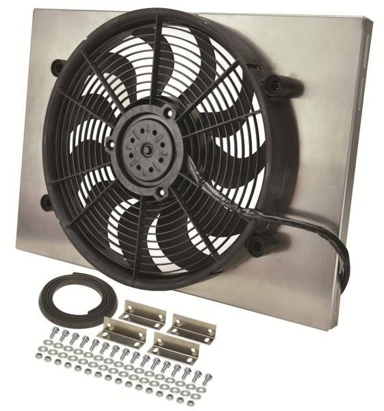

Fan a derale unit I use on all the classic cars I build here in Qatar

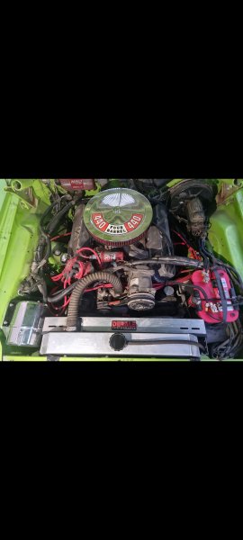

Here a pic of the bay
