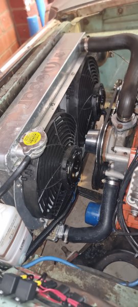

I will be installing a koolmaster water pump after doing what I can to improve air flow ( relocate trans cooler away from the centre of radiator, seal radiator support panel to.hood and removing one thermo fan as runs cool enough idling in traffic so may get away with one fan).

Car has standard cast pump and changing pump is my last attempt to try to cool the car( runs up to 220 at 3000rpm on highway after 15 minutes.Has 26" radiator, 2 x 14" fans, water wetter, 160 Mr Gasket thermostat. Thanks in advance.
