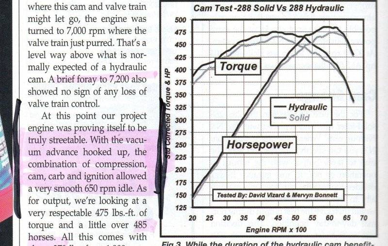

You need a looooooooooooooooooooooooooooot more timing at idle, probably about 40*. Your specs are similar to a 440 I set up last year; it idles with 42*. That was achieved by using manifold connected vac adv. Engine will never run good as it can until it gets the timing it needs.
Your shot gun fixes make it impossible for anyone to make an educated guess as to what it would take to fix your problems.
Agreed. Should’ve taken it one step at a time but
obviously your saying 42 total
Nope, 42* at idle. Read the bottom link in post #9.
