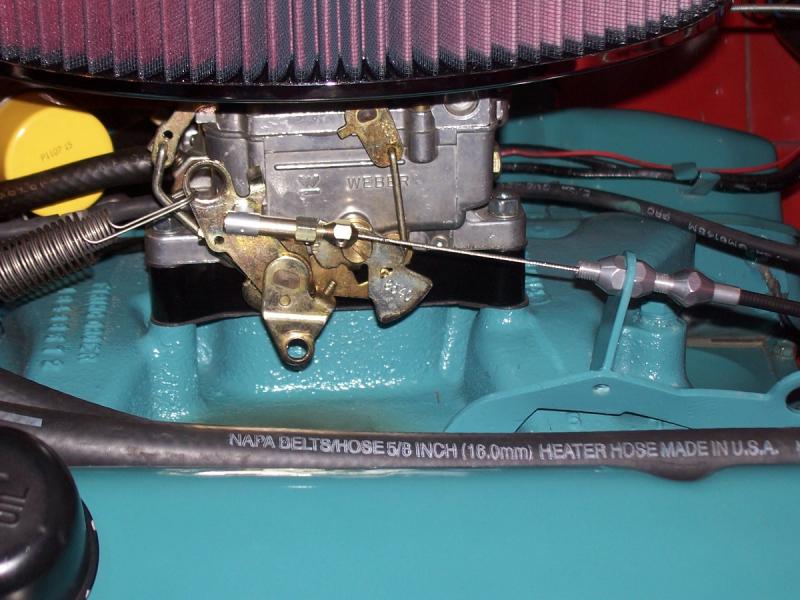

I donot have a holley DP on it....I have this thing...small 610 4 BBL
also have the 484 purple

I also had a problem with my throttle cable hanging up .....replaced it (cable) and with duel return spring.....it was hanging up.
...new cable also was a help
