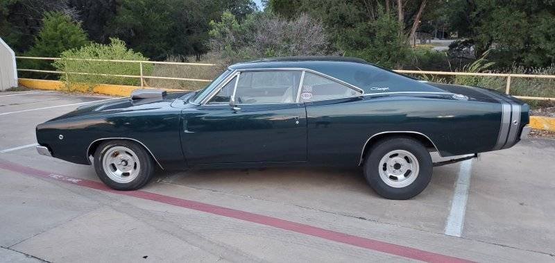

I have a Holley 4150HP 950cfm carb (no choke) on my '68 Charger with a 440. A little backstory, this car was ran on NHRA in the 2000's. Full roll cage, ratchet shifter, trans brake, big cam. I'm working to make it more street ready. Without the choke, it takes a good 7 minutes to warm up. I'm thinking of getting a carb (with a choke) more for the street or putting in EFI. Which way would y'all go?
I read these forums a lot and the amount of collective knowledge in here is tremendous. I appreciate all opinions and experience that y'all can share with me. Pic of my charger as she sits now.

Gorgeous Charger brother

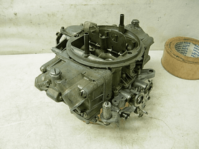

The origional Holley 3 barrel carb R-6404 Model 3160 950 CFM, HAD a manual choke blade assembly, cable operated.
Later addition rated at 1050 CFM and no down leg secondary booster venturi, but just nozzles in the center of the secondary throttle bore. I've no personal experience with the design, but know others who've had used them. Because of the large primary bores/venturii, cold operation was problematic and the manual choke had to be "feathered" until warmed up. Does your carb still have the choke shaft, blade, etc still present or has it been removed? The origional Holley carb (un-molested) are VERY EXPENSIVE....worth ~
$ 1200 and are not convertible to electric choke coil operation........ Just talking out loud.....

The 950HP does not have a choke.
View attachment 1344274View attachment 1344274View attachment 1344304View attachment 1344304
BOB RENTON
Like BSB said, there is no choke at all, never was.
