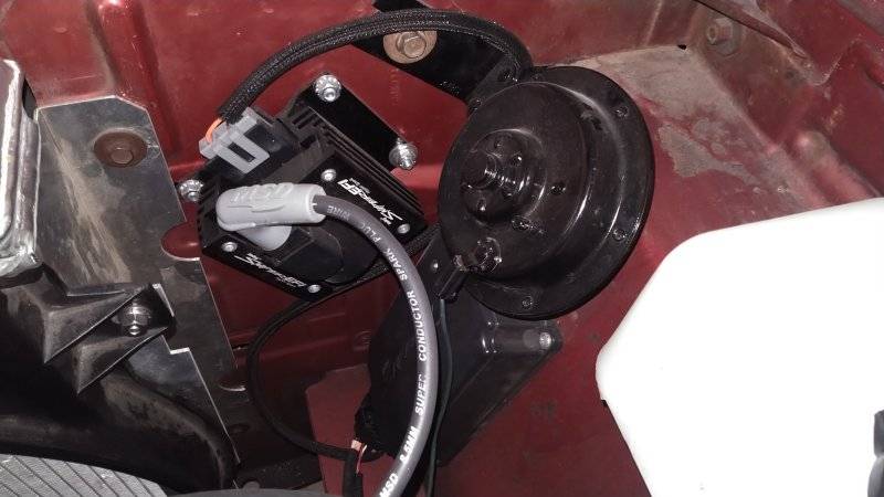

My hyper spark coil is mounted above the ecu on the passenger side of the rad. but I only have a 22” radiator. I use a single road runner horn to give me room. If I had an engine with distributor in rear I might be inclined to mount ecu under dash……

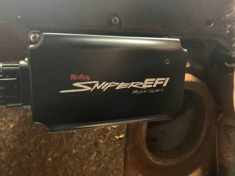

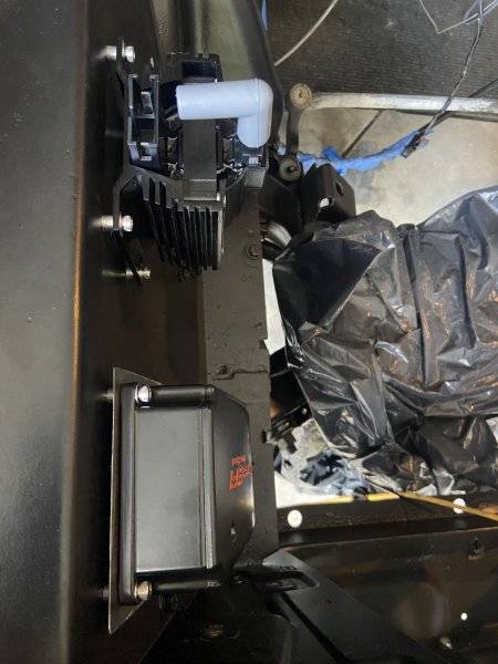

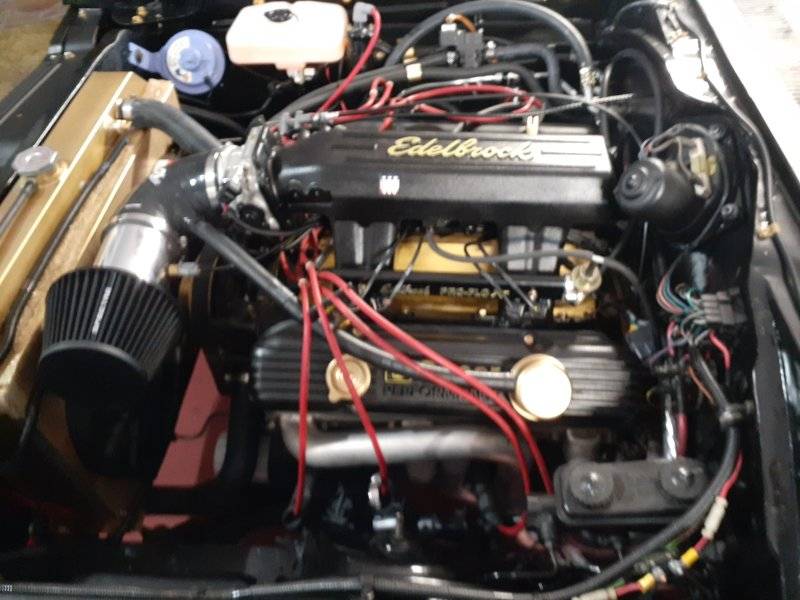

i mounted my e.c.u under the dash on the driver kick panel . if you look back on how the car manufactory's did there early e c u installs they were in the kick panels them moved to a shielded placement as other component's were interfering with speed signals and others. ad around a battery may get battery acid on or it get in to the wiring or e c u so take your time setting things up and test fit where you want it.

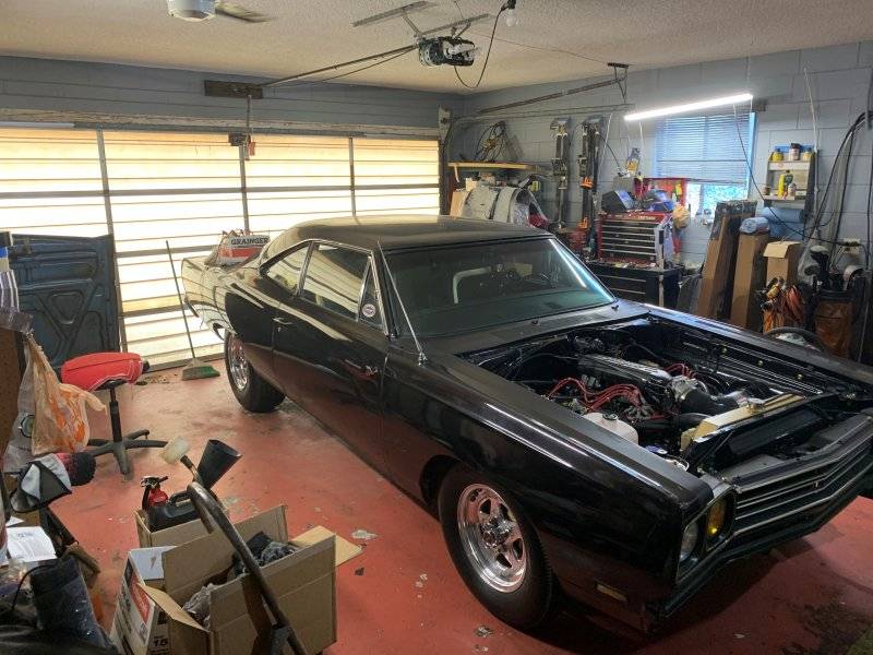

Appreciate the advice and the pics. Have any of the whole car?
not recant these are 2 years old i now have the hood and bumper on it now. took 4 years to go from 10.90 drag car to street now

Man she’s purrrrrty. What ya got for a motor and done to the motor?
it is 451 so 400 with 440 crank with mopar stage 6 heads fully ported small cam 489lift roller rockers use to run 600 lift solid cam it is fun on the street even with the a/c on
Got out to the garage to take a picture, hyperspark coil, ECU location on my Sniper equipped 66 Charger. No issues and completed Rock Mountain race week last year

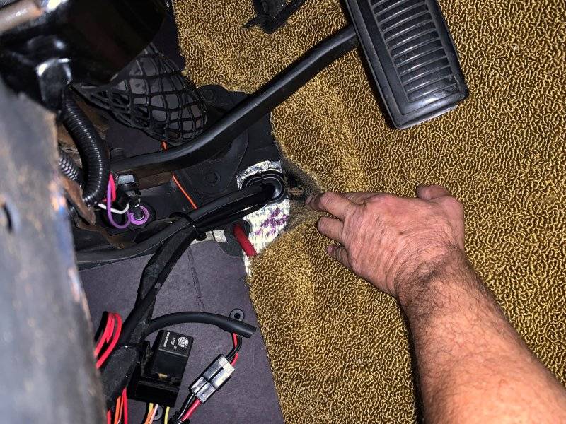

That’s we’re I’m putting mine. Holley said it will be ok. Really appreciate the pic. We’re did you run your wiring?
the 4 speed oval grommet i cut to fit the harness then pushed the harness thru the fire wall then snap the grommet in place like factory the silver is a Velcro heat shield wrap

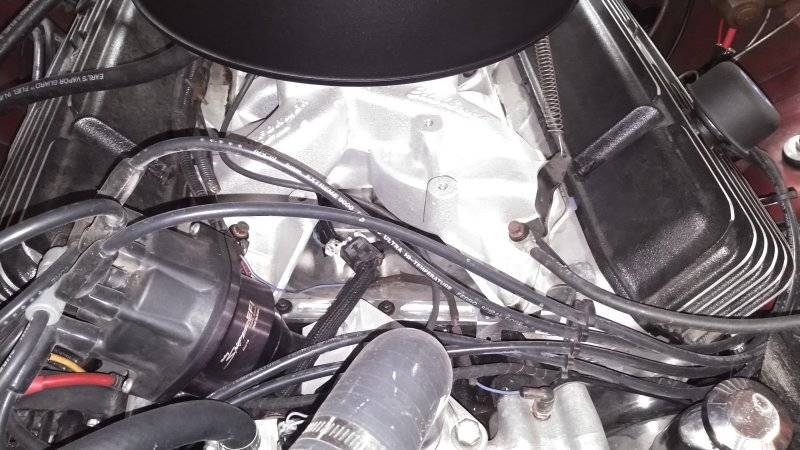

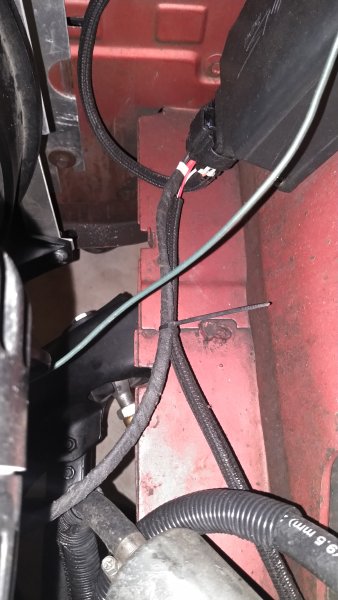

Red and white wire runs near heater hoses back to firewall. The other wires run behind alternator up to the distributor, wiring from Sniper to distributor and ECU runs under the intake manifold, heat riser passage is blocked

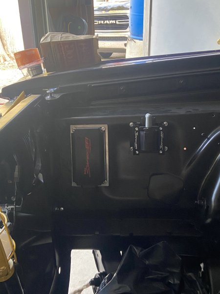

I ended up mounting mine on the passenger side inner fender. Just need to cut another stainless plate for my coil. I put spacers behind them and used stainless bolts n nuts.

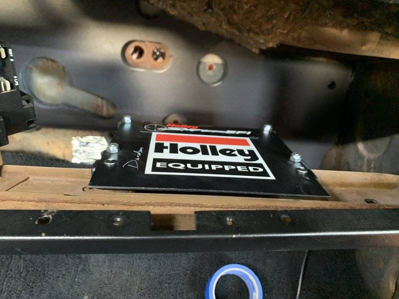

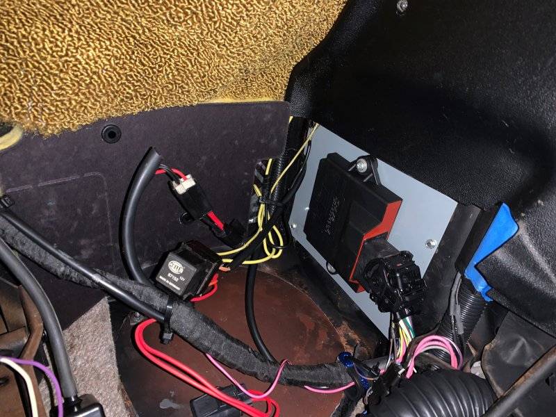

I installed mine under the dash behind the glove box for exactly the same reasons. Out of the heat, away from any EMI noise, short wire run through the firewall, under the intake to the coil/dist. Been working great and one less thing under the hood.
I don't have a sniper, but all my electronic ignition boxes, MSD or Mallory, are mounted high up in the passenger footwell, for the exact reasons above. I would do the same with a sniper.

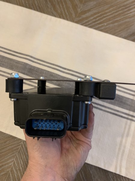

What is attached to your ignition box? Also what is the Holley plate that looks like it’s signed?
I made a bracket and put my last name.
Used 4 MSD rubber mounts to attach it to the plate. Also 3/4 square tube, that I capped the ends. It fits snug in the lower dash channel under the glove box.
4 screws and a plug, makes it easy to remove the module from the plate.
