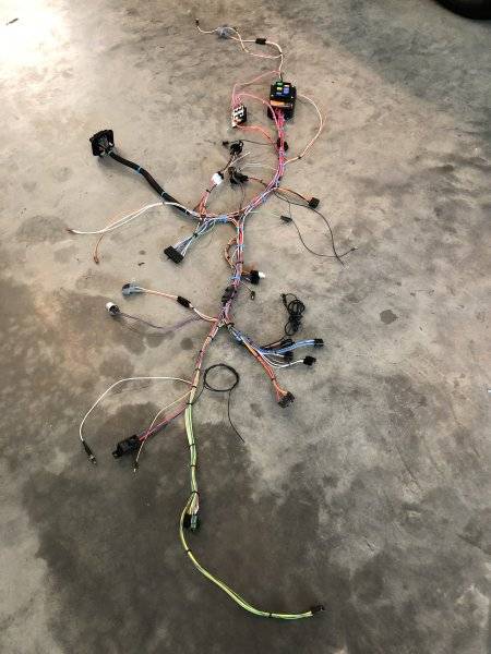

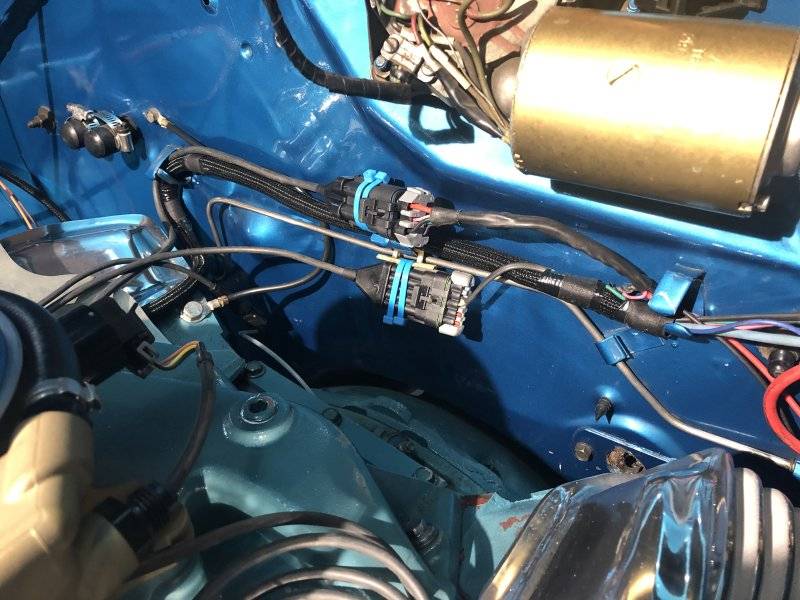

Just to show what I did on my Dodge - I used an AAW kit to rewire the car. That harness was also modified extensively because it's designed around GM stuff and made to fit out cars. (most A.M. wiring kits are like that) Their bulkhead was a nightmare. At the same time, I integrated the Holley harness into the AAW one which was not easy but it came out OK in the end.
There were things I was not quite happy with like the zip ties but sometimes you just have to push forward and finish. I tried to make it look like it belonged there or at least blended in enough where it didn't look out of place. 99% of the people that looked at the car had no clue it was EFI which is kind of what I was after.
