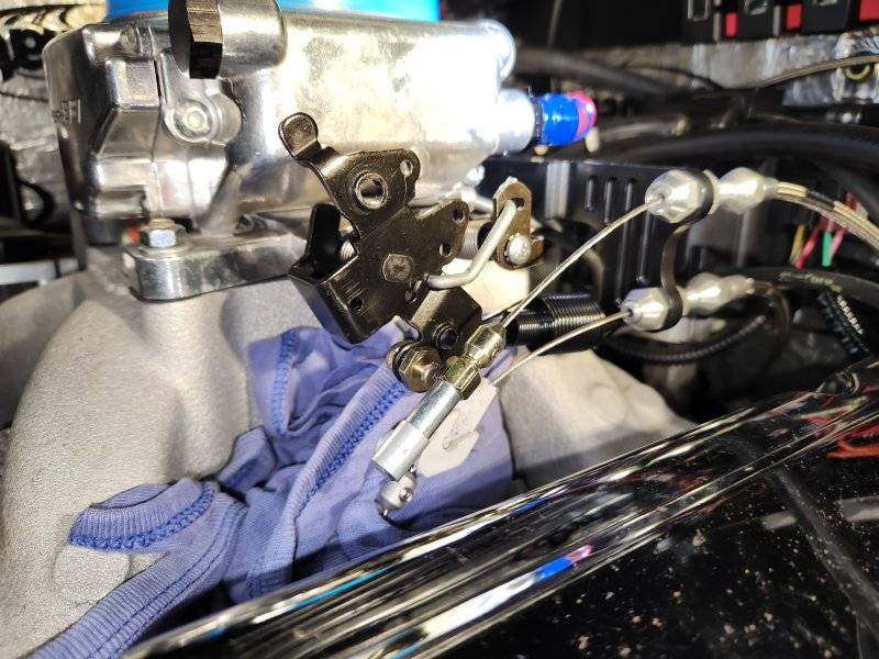

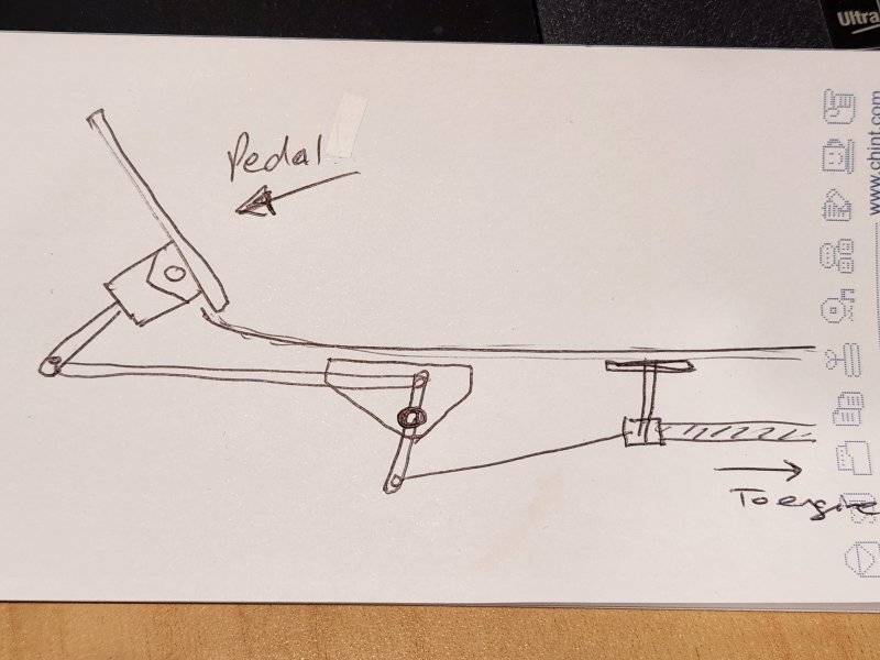

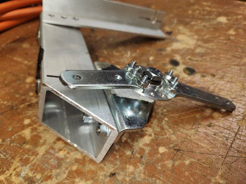

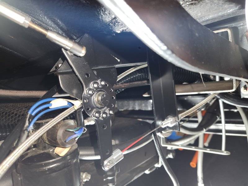

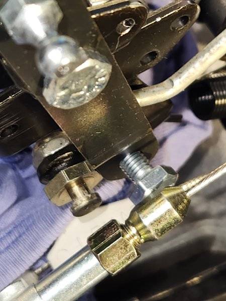

Posting this in the hopes that it might help someone else one day.....
I have been making some adjustments lately just to get stuff right ...or better at least.

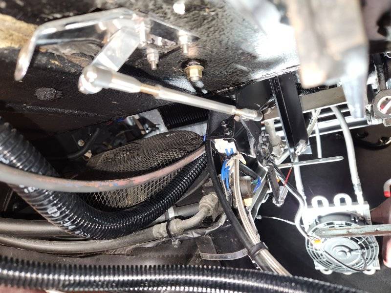

First up, I replaced the 96" long throttle cable, in favour of a more sedate 72" cable. :rolleyes: Remember I have a cab-over design, so everything is way different to a car.

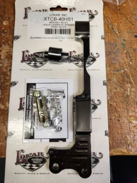

Next, I had to order a spacer (based on online recommendations) for the pedal assembly. That has just arrived this week, so will be fitted today/tomorrow.

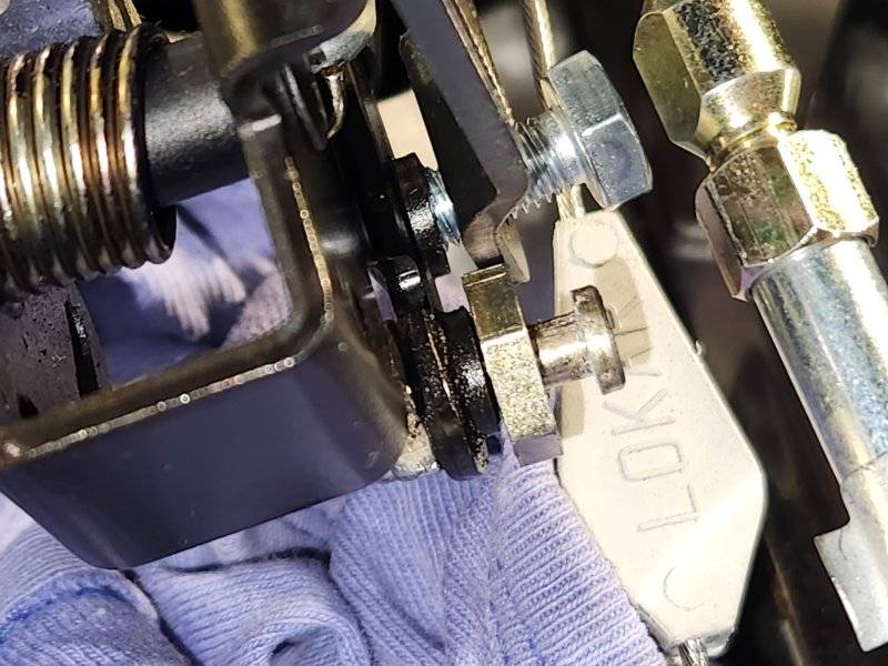

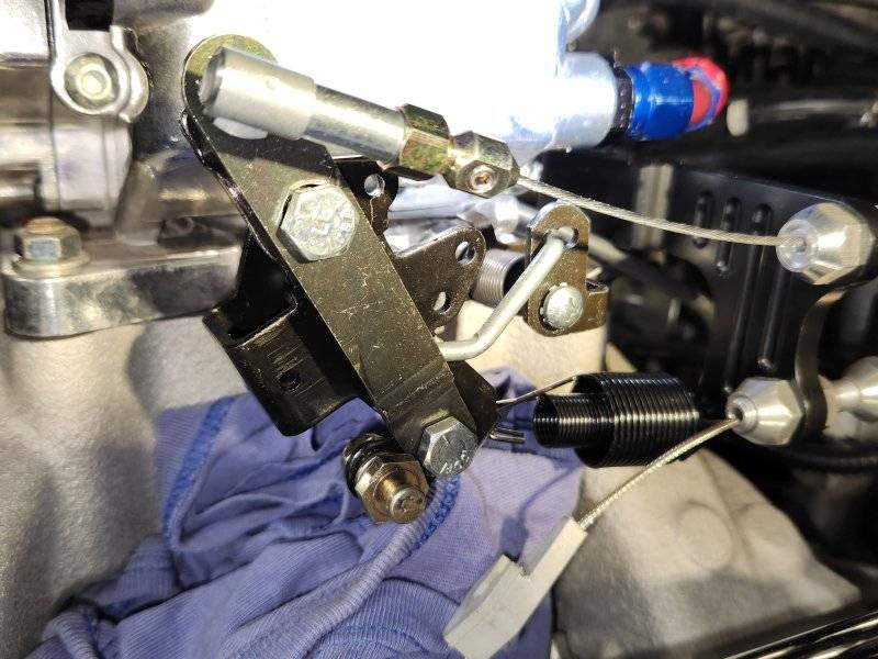

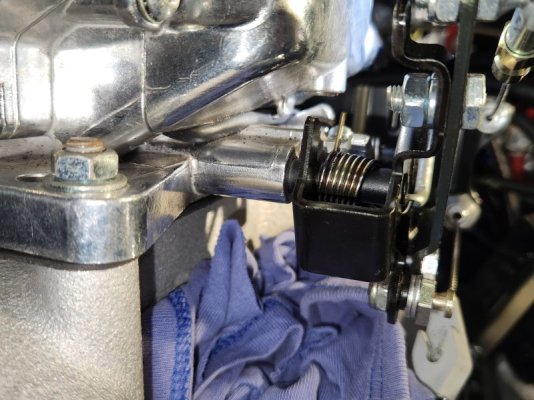

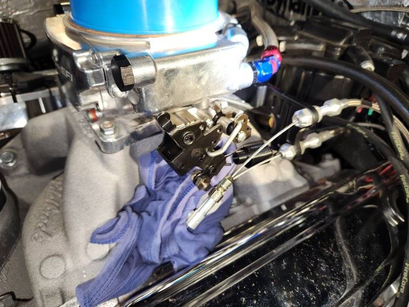

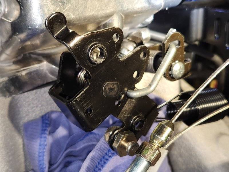

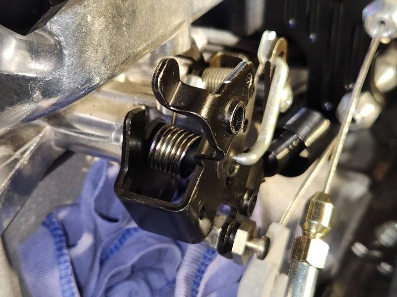

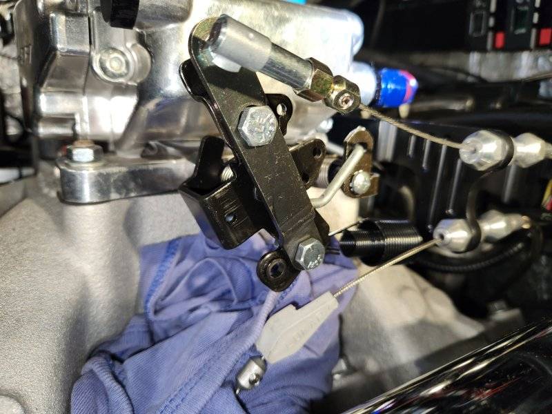

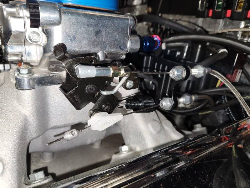

I also ordered a Holley 20-16 throttle arm extension kit. I have just finished fitting that arm.....and it was not quite as easy as they say. Online feedback is at best misleading, and at worst downright BS. Holley says "some spacer washers may be needed" ....No sh+t Sherlock....... they didn't say anything about the kickdown ball-stud flange nut being a problem. Anyhoo....with some perseverance and a few cuss words, it is fitted and working now.

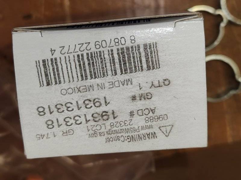

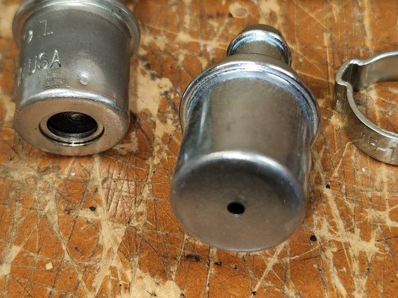

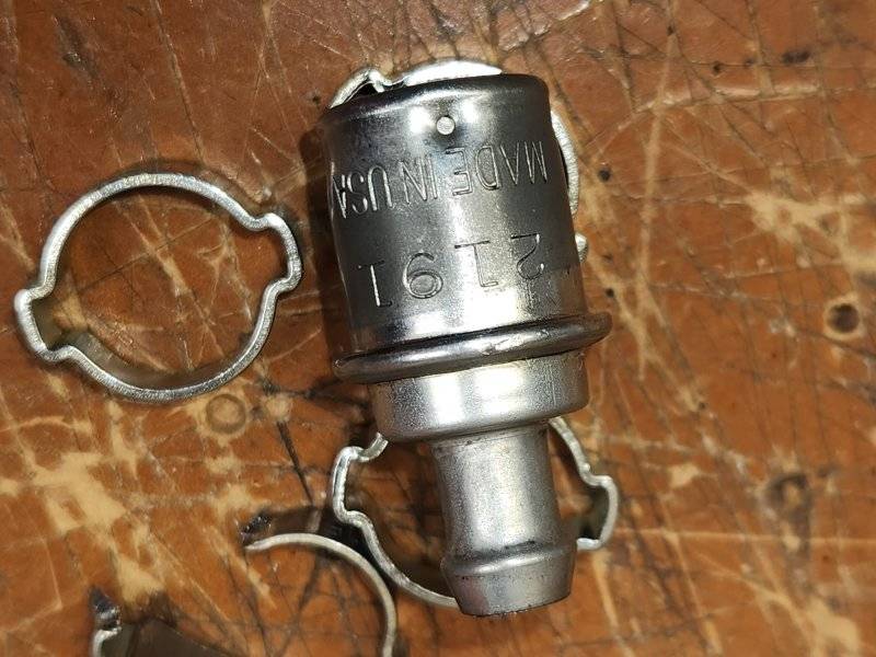

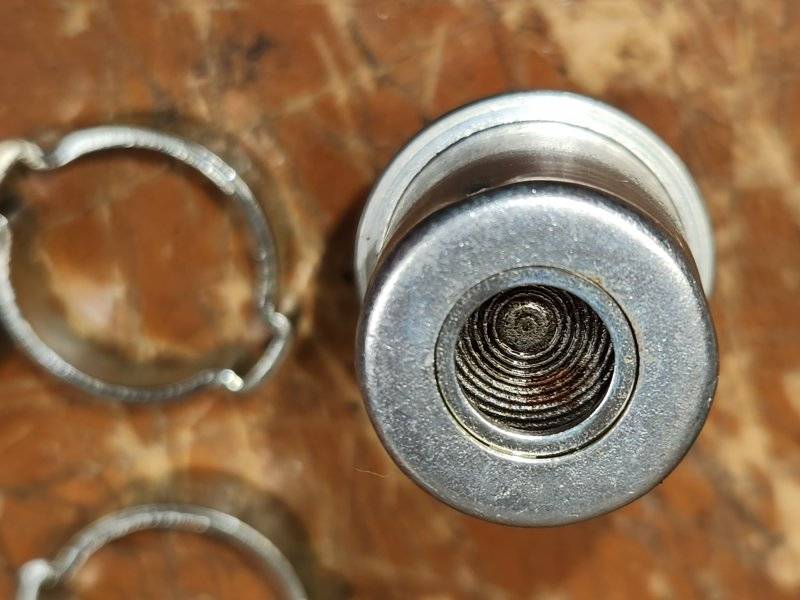

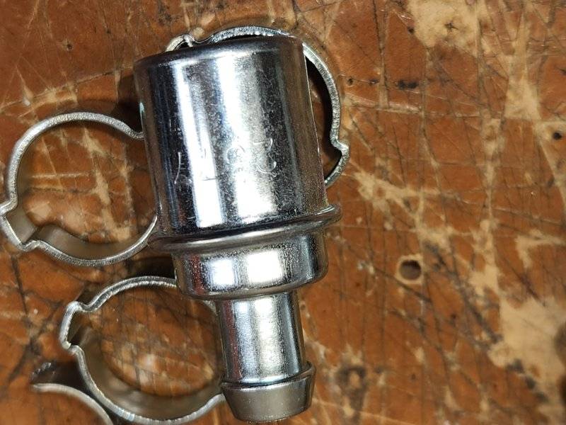

Part of the shipment that arrived was a new PCV - supposedly correct for the Sniper (or any EFI system) - small fixed orifice instead of regular large and variable internals. I discovered this by trawling through online forums where people had issues with the blow-by or rough idle conditions. Every little piece of information helps.
Hoping to alter the pedal spacer soon, then get the pedal and throttle adjustments finessed, and be up for putting the carpet down again. Part of those adjustments include the new bell-crank system for re-directing the throttle cable to make a softer pedal.
I need to be running next week for my 6-monthly 'safety checks' so I can cruise to my buddy's mini car show/60th party later in November.
:xscuseless:
20240504_090851.jpg20240507_153346.jpg20241024_155423.jpg20241025_232119.jpg20241025_232141.jpg20241026_232523.jpg
Some pics from this morning....
20241108_121850.jpg20241108_121853.jpg20241108_121858.jpg20241108_121904.jpg20241108_122358.jpg20241108_122402.jpg20241108_123151.jpg20241108_124108.jpg20241108_124116.jpg
A few more.....
20241108_124847.jpg20241108_124855.jpg20241108_124915.jpg20241108_124937.jpg20241108_124951.jpg
I have also bought a 1/2" phenolic spacer, but I will wait to see how things go before making more alterations. I only bought that to combat heat-sink.....which hopefully is partially achieved by the constant flow of fuel from the tank and back to the return line.
At least that's the way I understand it.

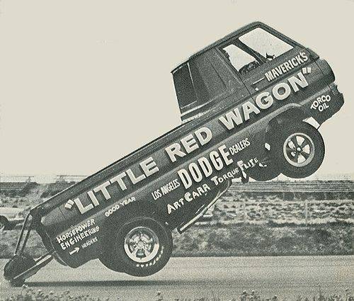

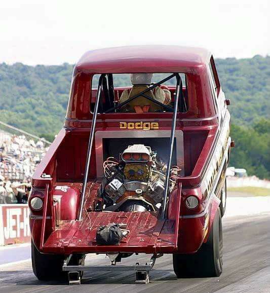

I've looked at those over the years, never clicked when money was available or room in the shop. Excuse my ignorance of the name Bill Golden, I assume he must have been the guy that ran one of those back in the day?
Bill 'Maverick' Golden was the guy who popularised the art of wheel-standing....with his famous Little Red Wagon (s).
Bill managed to wreck at least four of them over the years....he was a lucky survivor each time.
4513d27998943ff7329053450cc18d90.jpgLRW 2.jpg20180811_235801.jpg65 A-100 WS Little Red Wagon #6 @ Half Moon Bay.jpgDSC02562.JPGLRW.jpgR1-03667-0022.jpg
Rest in peace Bill.
thats very cool as I said before, That looked like one hell of a ride. RIP Bill.
