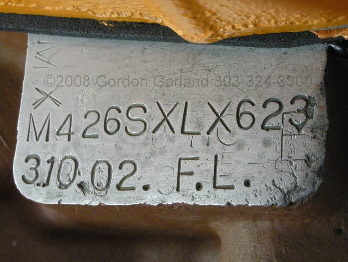

That dont look right. Never saw an ID plate restamped with DIFFERENT INFO.
I know......and I know NOTHING about MoPar stampings but I was thinkin the same thing.
I also think it's WAY too heavy handed to be a factory stamping.
Yup, I should say I know nothing about Mopar stampings either, but my 413 I actually thought the id pad was blank when I first saw it. The stampings are so damn faint you can only see em while holding a light at a steep angle. And mine are pretty damn in line.
Also, look at the nicks and dings in the id pad. Those stampings appear to cut through the nicks rather than the nicks cutting through the stampings.
