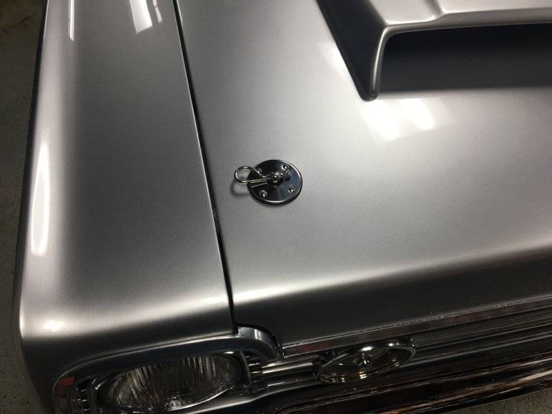

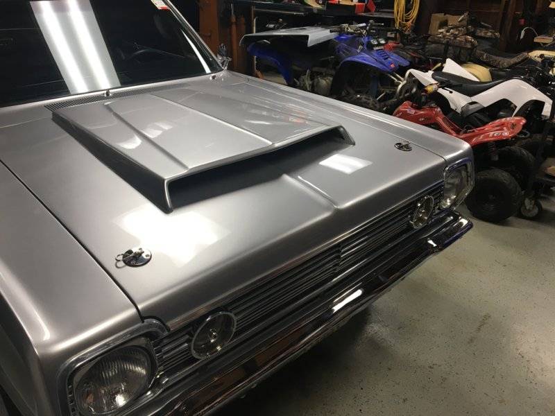

I have the AAR hinge hood with tall Hemi scoop, 2 pins no latch. The hood doesn't lift or bow at all in front at 128 MPH. My AAR hood isn't the lightest piece, but plenty stout. The lighter, pin on style hoods probably need the extra 2 pins IMHO.

Agreed, I have not seen my AAR hood bow at all either. It does lift up in the back a bit but I think that is the slop in the factory hinges.

You're going to need 2 right in front between the 2 you have there. That front end will want to lift right off the car and tear that stock latch off the fiberglass.
Can we see some pictures of your car? Maybe 1 outta 10??
