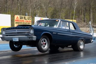

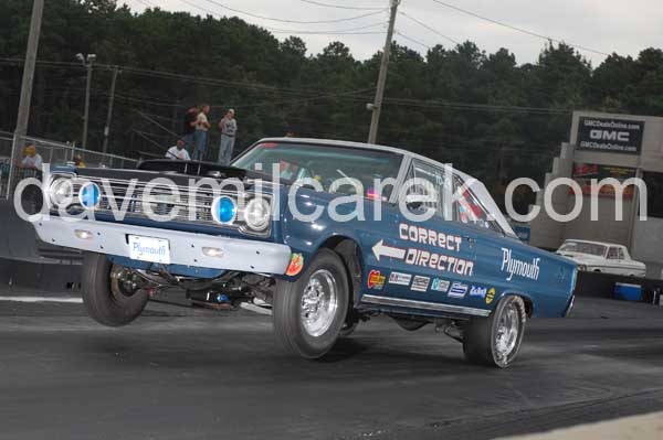

Just put the ladder bar is one higher hole on the crossmamber. It was hooking great.Nice and straight and pretty high but it just seemed like it wanted a tad more. Hope it doesn't go too high.:grin:

I can fine tune with the frontend with the double adjustable shocks. I'm one hole down from the top. It use to be in the top hole and it was crazy. I brought it down 2 holes and it was a much calmer ride but not fun enough. I like a little unpredictability.
its all fun until you snap an axle in a wheely and suck the wall!i know for experience.try to keep my fronts at about 6 inch max lift now.
I'm not a fan of big wheelies either.....pulling em 8" and having a gentle landing is good enough. Imo, anything more than that is wasted motion. Looks cool tho lol
