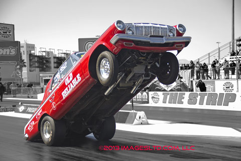

as long as you get a soft landing,and dont unload the rear tires with a hard landing,you can go 3 feet high if you want.the momentum loss for going up is offset by comming back down.simple physics.have all the fun you can handle.
Huge wheelies? How fast is the vehicle moving when the car crosses the 60' mark and how high is the front end still? How much air is catching the under side of the car when it's at a 30 degree angle and how much air is starting to get rammed into the hood scoop when it's pretty much out of the air stream? I can understand why the Super Stock guys want them but if they were all that beneficial, why doesn't all the other fast and faster classes use the same physics?
thats what i dont want to do anymore.lol
this was too high..... it doesnt accomplish anything but....a WOW FACTOR
Usually messes things up on the landing too. Iv'e seen very few cars do that without damage of some kind.....
