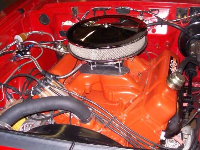

As was said you need to know if it is a return line system regulator. I use an electric pump and mounted my regulator on the fenderwell as you can see here. Mine does not use a return line but I have bought a regulator that does use return line as I may go to that type later. With the return line system the fuel is kept cooler since it is always flowing and that helps alot in the real hot humid summer weather if you run this cheap pump gas we have now. I do run on pump and had some fuel boiling problems this past summer with this pump gas they make now. Many still use the deadhead system and it works fine as thats all we used back in the 70's. But if you live where it gets real hot in the summer then the return system is a good idea. Good luck , Ron
