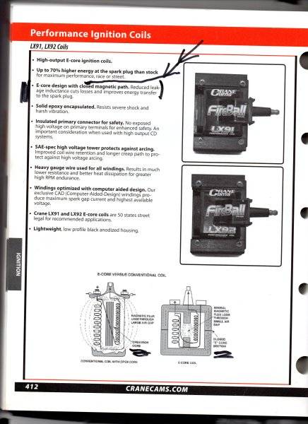

Below is one reason [ one of many reasons ] why the Chr elec ign is not as good as HEI.
