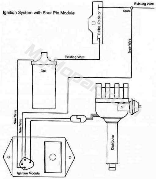

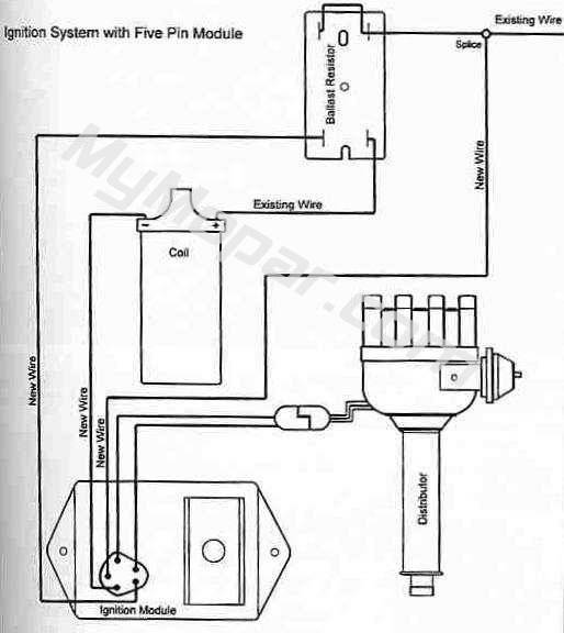

I think I may have solved my problem. After some research on the slantsix forum and a few other mopar sites found on google, I think I have a 5 prong ECU wired up to a 2 terminal ballast resistor, but with 4 PRONG WIRING. Whoever owned the car before installed the chrome box and 2 prong ballast, but then plugged in 4 wires to the 2 prong ballast. Could that be why my coil is so hot and not giving spark in cranking mode?
I will confirm tomorrow if I have the correct 4 prong ECU to go with the single 2 prong ballast and then confirm that the wiring to the ballast is correct.
Hope to have this solved by tomorrow. I hope I didn't fry my new ECU and coil by not noticing this sooner...
Most new ECUs are 4 pin. You cannot tell by looking. Some brands of ECU HAVE 5 pins, but the 5th is not hooked up
You have to use a meter on the 5th pin to determine if it's hooked up
Here's the 4 and 5 pin diagrams:
What is NOT shown in these diagrams is the brown bypass circuit (IGN2) which would hook to the bottom terminal of the 2 pin resistor, and the bottom right terminal of the 4 pin resistor.
You can use a 4 pin ECU with a 2 or 4 pin resistor, but a 5 pin ECU REQUIRES a 4 pin resistor

The chrome box ECU I have is a 4 wire and a 2 prong ballast resistor. The problem was that "the ignition 1" cranking side of the ballast on the left did not have a connection going to the coil positive side. I took it to my go-to mechanic Friday and he couldn't figure it out at first either, but then after I provided him the schematics for both 2 prong and 4 prong ballast resistor systems, he identified the issue.
That one wire from the ballast to the coil now provides excellent starting (duh!) and the coil is not quite as hot now since the it's now seeing the slightly lesser than 12V voltage after the ballast.
