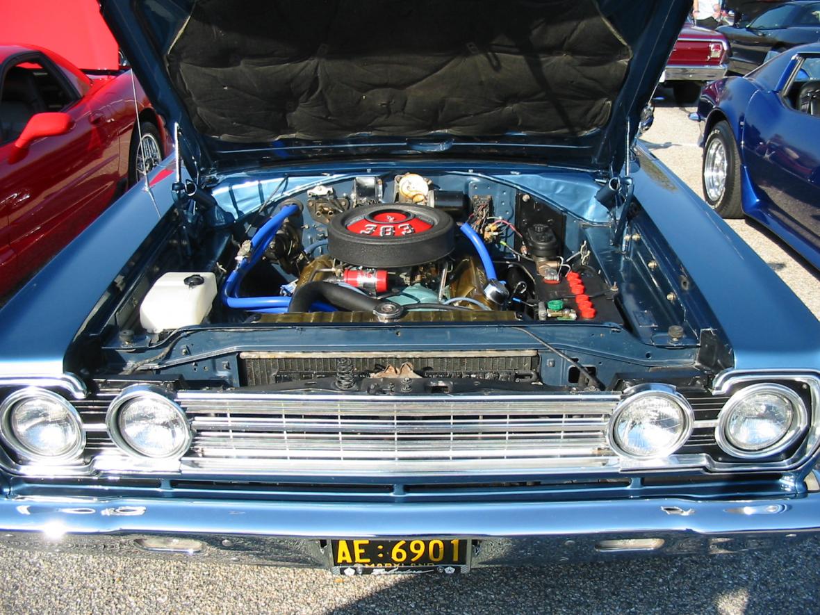

Hey Guys, I've had this problem for a while now and haven't been able to chase it down. I can hop in the car, my 67 Belv 383,10-1, 484 cam,and pump it 2 times and it will start after sitting in the garage for up to a week, much longer and I crank first then pump 2 times and it fires. Problem is after reaching temp and turning off then restarting after 15 min. up to 2-3 hours I have to crank and pump 4-5 times and hold 1/2 throttle to get it to fire. After starting no sign of black smoke, doesn't act like it is flooded.The problem started after I installed an MSD6AL and new NGK plugs w/ .050 gap.I removed the ballast resistor from the ignition with same result. If car sits long enough for temp gauge to go to 100 it will fire off w/ 2 pumps. I don't smell gas in the oil, any thoughts? Thanks for your input

Starter and ign wiring are routed as stock w/ MSD wiring added to engine harness. I mounted the MSD below the washer bottle on the pass. side fenderwell. I have considered moving it but did such a nice job on the wiring and really don't have a better spot in mind. The car has an A/C heater box that eats up a lot of the underdash area. Only other spot I can think of is in the glove box, but it won't get any air in there either.
Edelbrock carb? I cant tell from the picture. If so they have a problem like that and I have had it happen with holleys also but its called heat soke its like vapor lock where the carb body gets hot enough to allow the gas to expand and drip out the needle and seat and into the motor when its warm leaving the float bowls almost empty and the motor full of gas but not so much that it acts flooded, but is hard to start. Run the motor get it up to temp and then shut it down pop the hood get by the carb and listen it may take a few minutes but you will hear what sounds like gas boiling. they make a heat plate to put under the carb to help with this. Keep us posted!
