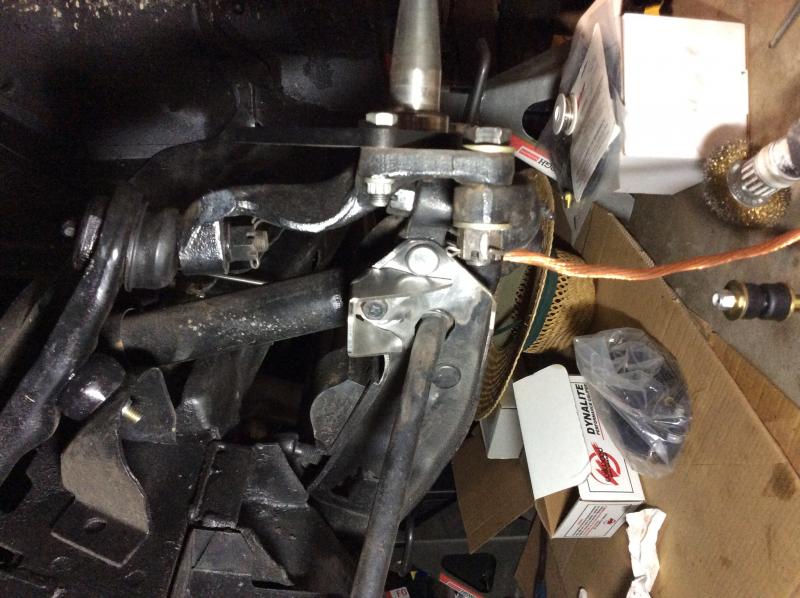

I'm welding up my front sway bar brackets on my lca's soon. My 66 net did not have sways oe installed.
Will be doing rears after. Those should be easy.
I'm only doing front and rear sways at the moment. Keeping all else stock cept adding Wilwood disc brakes up front. Rears will still be drum drum drum drum drum...
