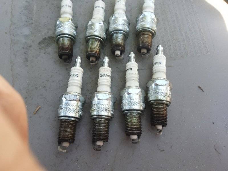

And yet here we are looking for a spark plug...Which is also a tuning aid. Misses until it warms up, Unusual ?

I came here looking just for a little hotter plug for a cleaner burn.. Motor only has 23,000 miles on rebuild (timing gear plastic was broken but since I had it apart I just rebuilt it anyway, Motor was very clean inside, barenings showed no ware) , whole car only has 75,000 miles on it (own by an old lady).
