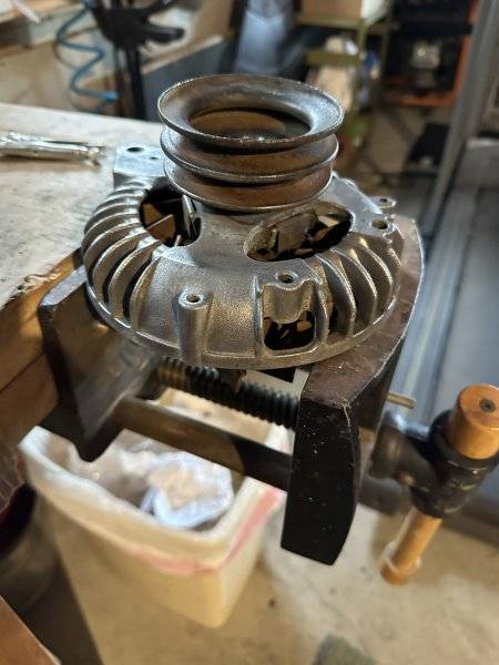

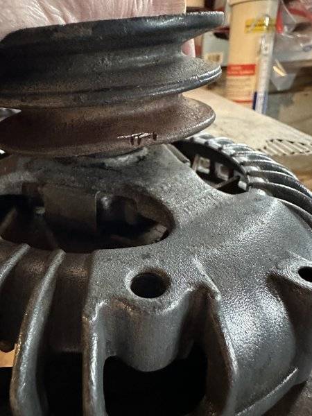

I've been trying to remove this pulley from my alternator and it's not budging. All I've been able to do is to bend the inner pulley a bit. Any suggestions? (It DOES come off, right?)

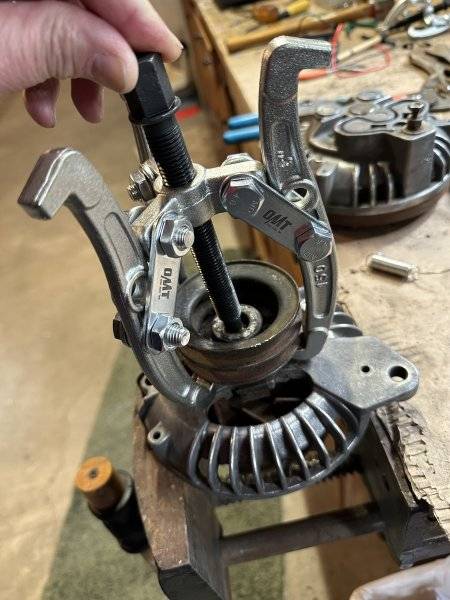

I've been using a three prong puller; that's not right?

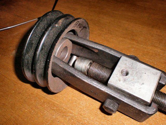

Mopar alternator pulley puller. Does p/s units too. Jaws go around the little nub down inside the pulley and the sleeve holds them together as you tighten up the bolt. Various companies make this.

That puller works on P/S pullies and single groove alternator pullies but the double groove alternator has the hub recessed and that puller is to bulky to reach down in the recess to grab the hub...
EXCELLENT PIX........the puller shaft pushes or reacts on the alternator shaft. Sort of a especial tool. The alternator must be disassembled to press sheave back on.....an excellent time to replace the front bearing using an SKF or RBC, NTN etc brand # 6203SFF, sealed double shielded pre lubficated, single row ball bearing. Stand the assembly on end (brush end down)and slowly press the sheave on the shaft . The procedure is outlined and depicted in the FSM. DO NOT HEAT THE SHEAVE TO INSTALL.....it's an 0.001"-0.0015" interference fit on the shaft WITHOUT key.

I changed mine from a double to a larger diameter single using one of these. $38 on Amazon or rent it for free at Advance Auto. Yes you have to split both halfs to press it back on.
Khryslerkid, That’s the ticket! rent one unless you like to collect tools you rarely use…. Like me!
