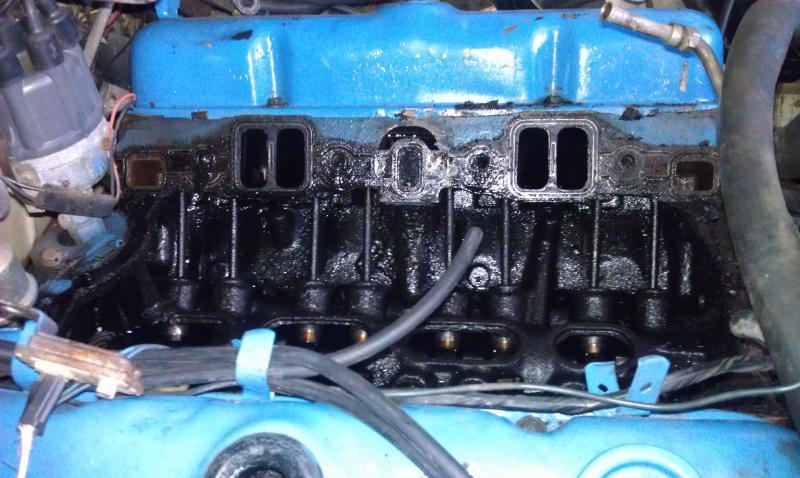

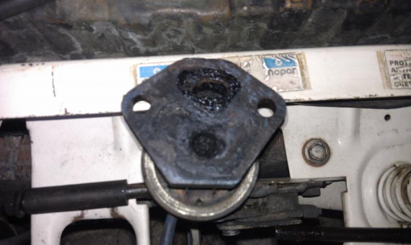

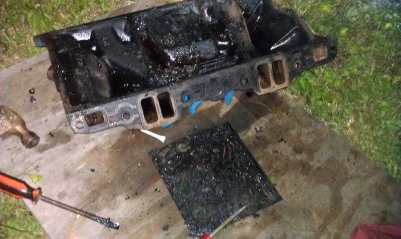

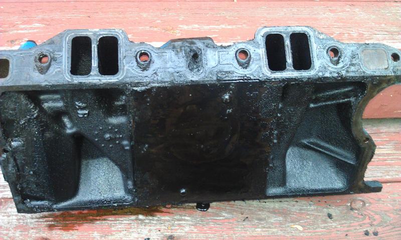

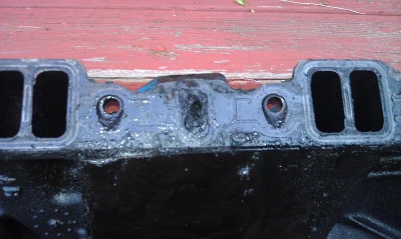

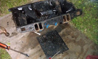

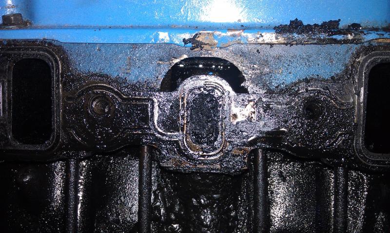

i actually ended up getting the plate off very easily i used a claw hammer and a mini sledge i put the claw on the edge of rivet and hit the hammer end with the mini sledge. the claw slowly worked its way under the rivet and popped them right out without any damage. you were right it definitely didn't give me access to the inside of the heat crossover but it was jammed full of nasty stuff i didn't want in there. the 2 holes directly under the carb that feed into the heat crossover and the 2 that go to the head were plugged completely solid and i literally had to chisel that crap out but seems to be clear now. the holes under the egr and the egr itself were also plugged completely solid as well this should make a difference in some way. I just have to figure out how to clean the ports out on the heads now with out pushing the crap further into the heads. IMAG0259.jpgIMAG0258.jpgIMAG0254.jpgIMAG0252.jpgIMAG0251.jpgIMAG0261.jpg
this poor old 318 has seen better days looks like some one in its history didn't change the oil frequently enough
keep it out of the engine but the little that will get into the exhaust manifold will burn up or travel into exhaust
so put your vacuum there and beat it out
People often close these holes on purpose, you aren't going to hurt anything during warm weather by having a blocked cross-over. If you're going to have another engine soon, you may as well just leave it and enjoy a cooler, denser intake mixture.
