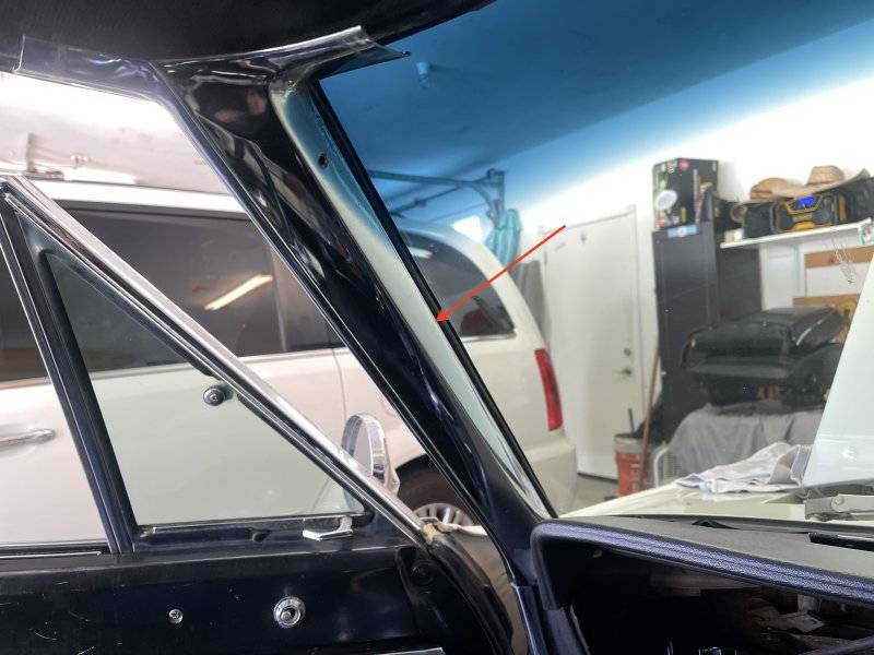

I'm working to get my headliner down, I've removed the trim over the door and windshield, but this one on the A pillar is loose the screws are out, but it doesn't want to come free.
I don't want to force it or yank on it.
Suggestions?

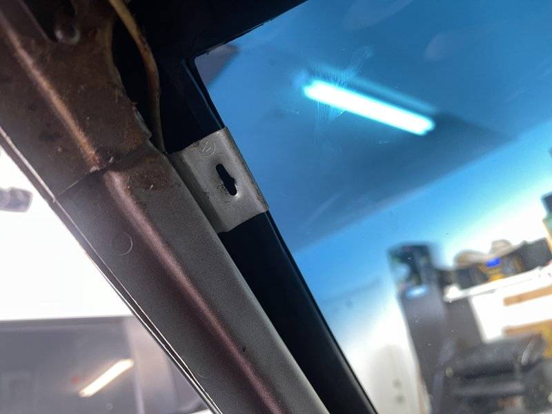

There's a clip on the inside, close to where your arrow is if I recall. You need to grab it and twist the whole thing toward you, from the windshield edge.
There is a clip on the inside, I had to be a little persuasive, but it came off. The clip is soft and I did bend it, but I can bend it back when I reinstall.
