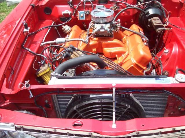

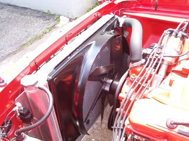

Mine would heat up sitting in traffic and get to almost 210 and I did not like it. So I added an electric fan as a pusher on a toggle switch I turn on when needed. And I made a shroud work for it. This hot weekend at Carlisle it never went over 200 sitting in traffic for a 1/2 hr. On the highway when it was very hot it will get up to 190. I may go with an even bigger rad later but its working good enough that it does not worry me. As long as it stays about 200 or less I am happy. Ron
Here is a pic of the shroud I modified. Oh and this is with my new 493 eng that seems to run about 10 degrees hotter then the old 440. Ron
Nice looking! How wide is that radiator? I've had several people tell me that cross flow radiators are more efficient than down flows because the coolant stays in it longer....
Thank you. The rad is 26' FROM SIDE TO SIDE INCLUDING THE TANKS. tHE CORE PART IS 22" AND THAT IS THE ONE mANCINI SAYS WOULD FIT MY 63 AS IT DID. iT IS AN aFCO THAT COMES WITH THE BRACKETS ON IT. yOU JUST HAVE TO LINE IT UP AND DRILL THE HOLES IN THE BRACKET. i WENT THIS WAY BECAUSE IT WAS $350. VS $550. FOR ONE THAT BOLTS RIGHT IN. rON
