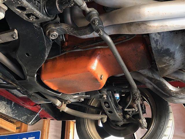

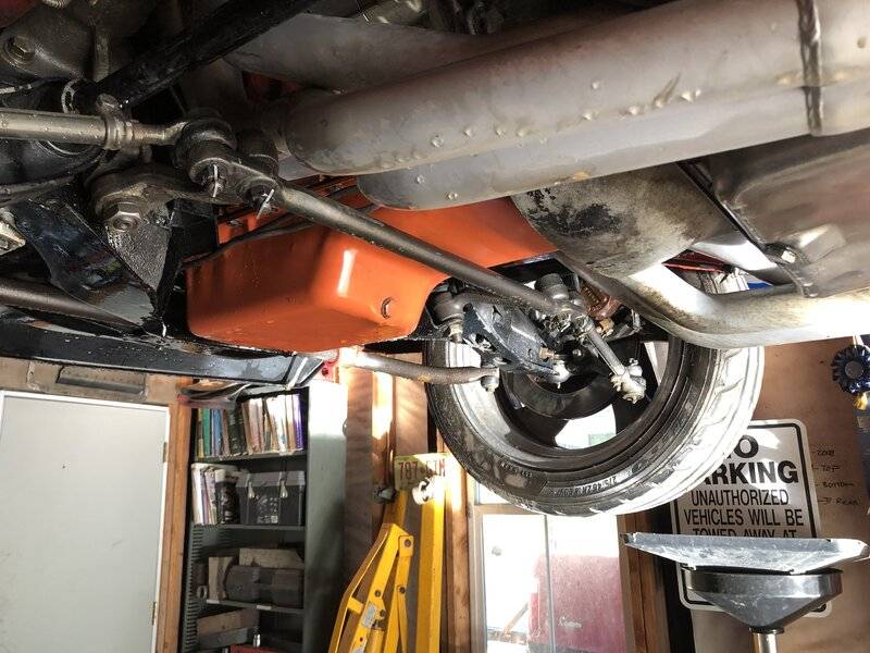

I put the car on the lift and spray down the oil and grease, then wipe it down with rags. No matter what I do, I have yet to get this engine to be totally leak free.
