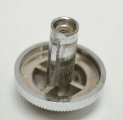

If thats the case the key on your button has worn down....

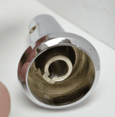

Couldn't find a picture of a 66-68 that showed the key but I did find this Eye Candy...

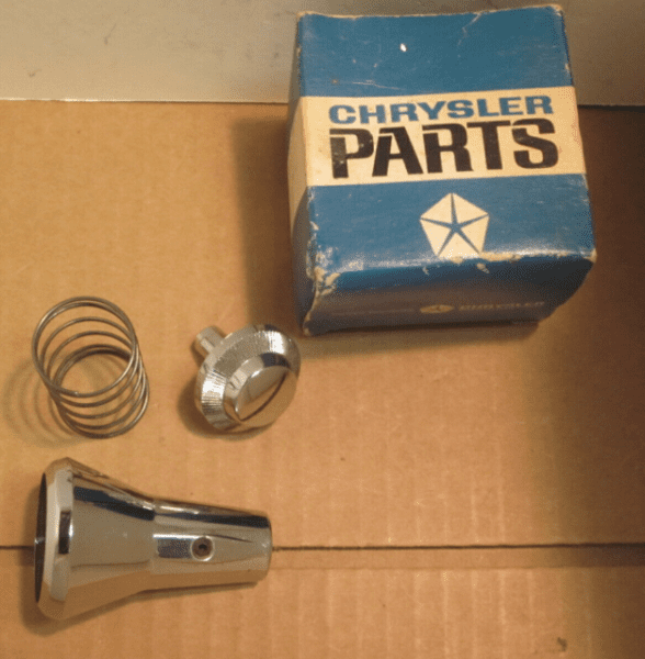

And I found a couple photos of the 69-76 style...
