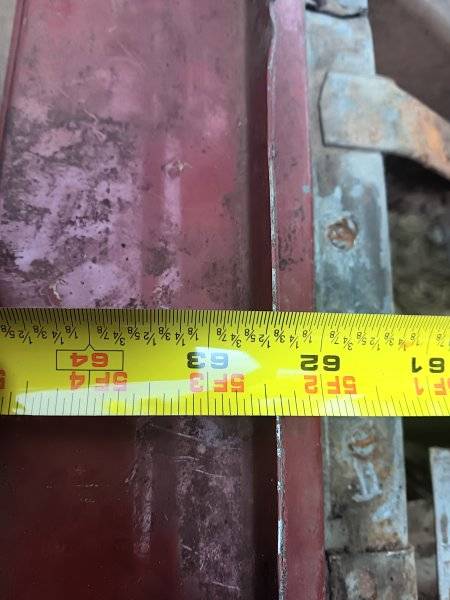

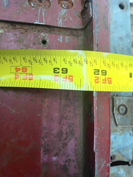

Here are the pics that are just in front of theTB Crossmember @ 62 3/16" and a pic just behind about 3" past the back edge of the TBC and it comes in at 62 7=16" inches.
The space in between measurements is only about 10 inches. Seems a little strange to me,
as this car has never been wrecked. We have drilled this car all the way through, and no collision damage or wrinkles that we could find. I'll take another picture tomorrow at the base of the B pillar. Its just been a hard day, as my brother just got rid of his girlfriend today of 17 years. I'll contact you tomorrow.

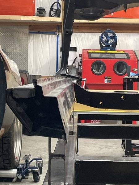

The measurements are different being only 10 inches apart i believe is because the rocker are bowed like your shin! Hard to see in the pictures I sent, but it kind of curves out in the middle.
