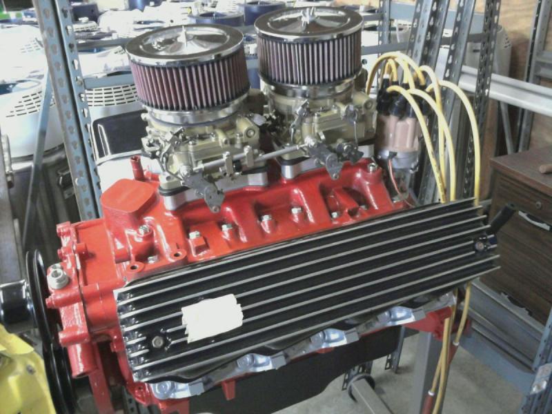

A LOT can be done with a 318. All the mags have shown you how, plus, people were doin it before the editors of those mags were even born. I love it when people holler about 700 HP. Most of those people have probably never felt an honest 400 HP. You can build a 12 second street car real quick with a hot 318. And I mean 12 ohs if you do it right and still have some driveability. Just use what you have. It'll be fine. Oh and to the ignorant ones who say Chrysler never made a performance 318, what's this? Same bore, same stroke, just in a little different package. And what's that? A FACTORY dual quad intake. And what did police cars use all through the 1980s? 318 4 barrel police package motors. They were not passenger car engines.
I spy...a Poly! :hello2:
Off the show room, with that dual quad, it was rated at 290hp...and that was before any tinkering took place.
