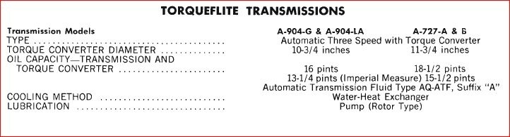

Just going to replace the trans oil, how much do I need? 1 quart enough?
your looking at around 6 quarts if you drop the pan and filter change.(that was on a 904 trans)
From 67 service manual
I presume mine is a 727 as its a MT? so how many bottles in 18.5 pints :)
do you mean manual transmission (MT)??? 727 is an automatic.
If yours is a 4 speed manual A-833 the gear oil capacity is 8 1/2 pints , 4 1/4 quarts, about 4 liters.
