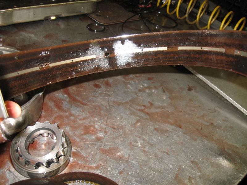

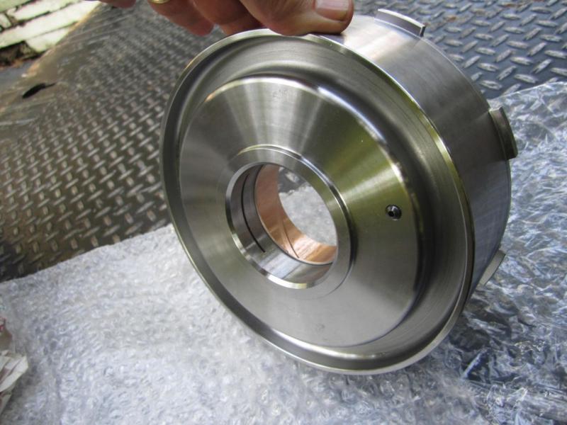

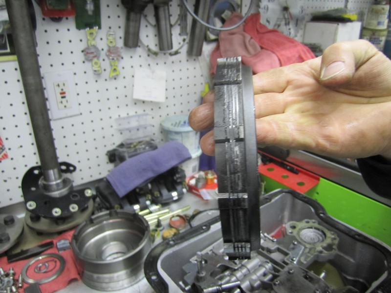

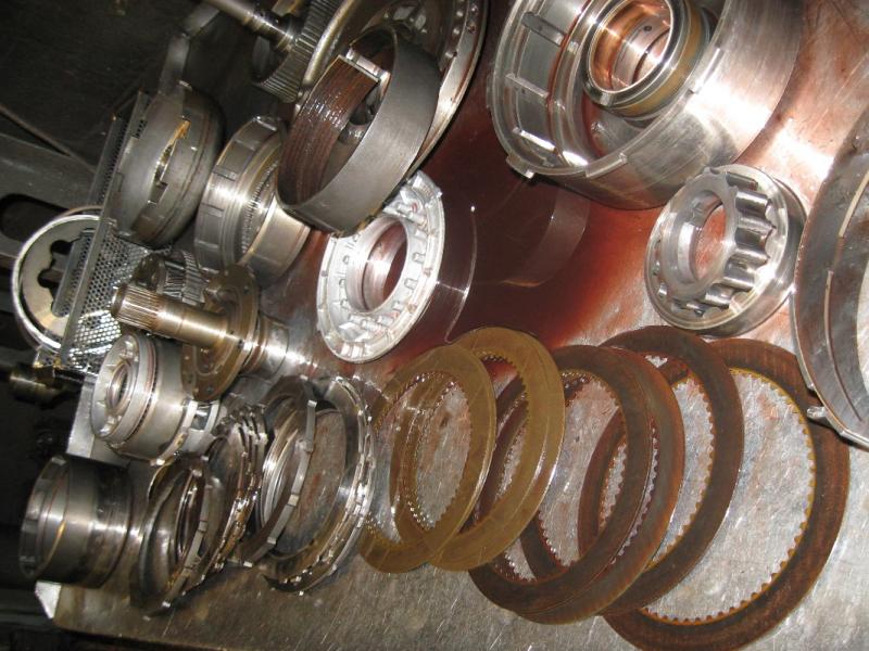

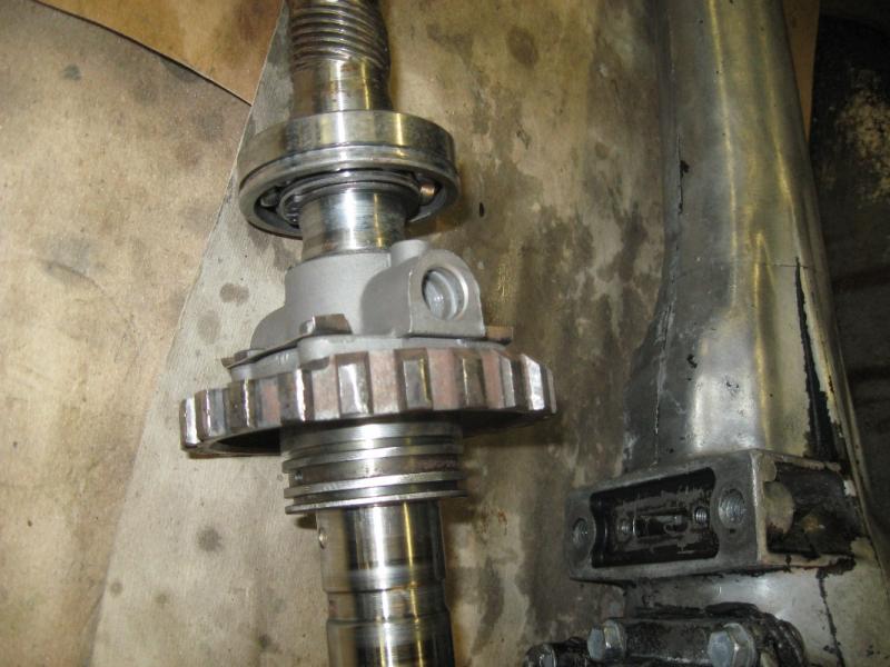

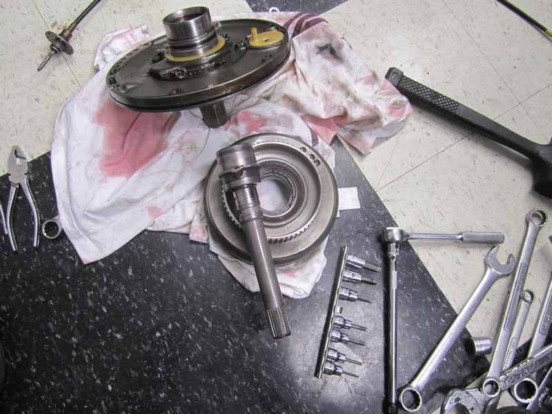

Start with a trans shield.:icon_winkle::icon_winkle: A billit drum is a good idea along with a bolt in sprag and steel planets:blob1:
I have broken several parts as the wick gets turned up:glasses2:

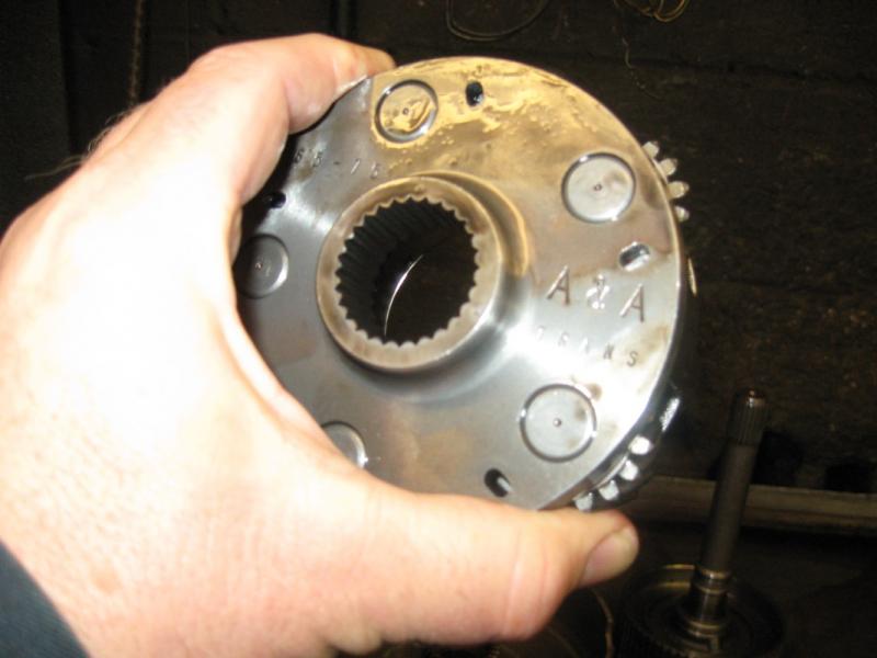

You broke one of A&A's planetary gear sets??? :icon_pray:

Well, I didn't go far enough then. Only 3700 in the tranny, and I thought I was playing it safe.
LMOL:rolling: No,that's what I replaced the stripped aluminum one with.:naka:
BUT,,,,,,,,I will continue to try and break it:blob8:
