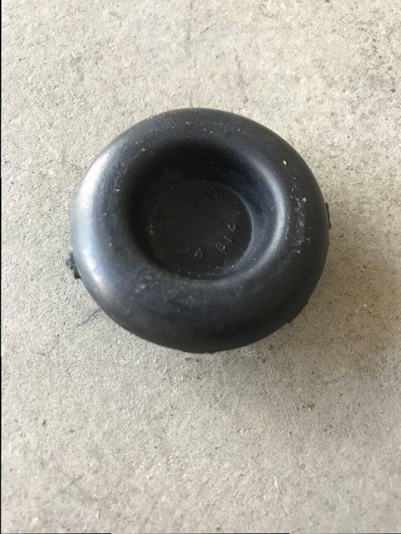

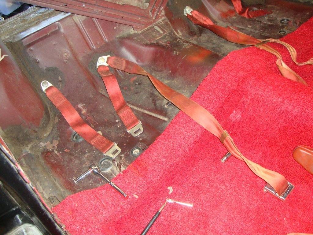

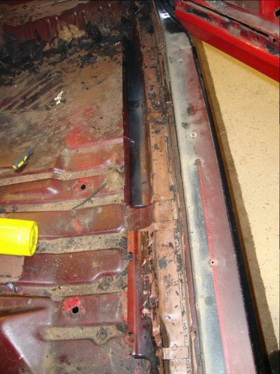

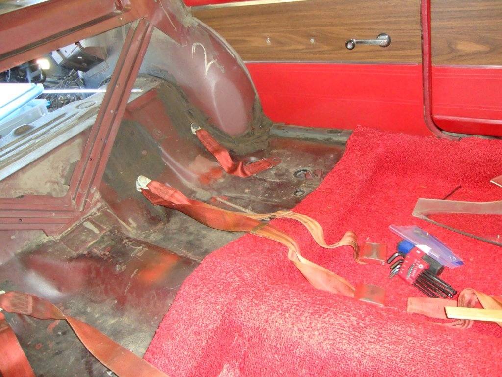

I've got some floor plugs to put in but they don't seem to fit. The hole measures .981 and the plug measures 1.170. I tried to boil it to soften it but it didn't work. Are they the right ones?
Have you tried using some WD-40 or a little ATF on them?
I've tried soap, jelly, pinching it sideways and then snapping in as well as a punch and pushing through the center and a rubber hammer. And I just got done trying WD40.
There is no way these can be this tight.
There is 6 of them in the kit. I'm assuming they go behind the drivers seat. The holes in the trunk measure the same diameter.

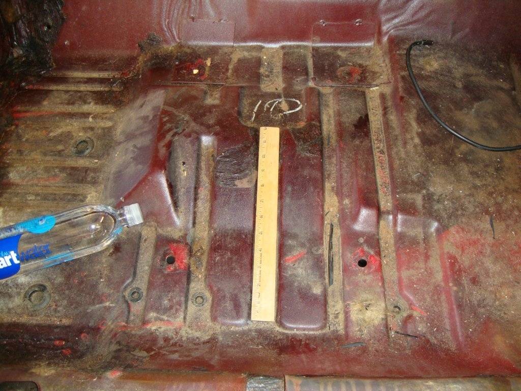

They do not go inside the trunk area. They go inside the seating area.

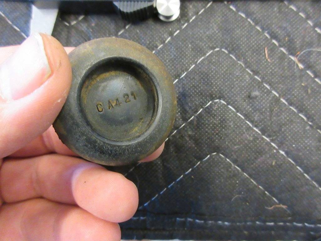

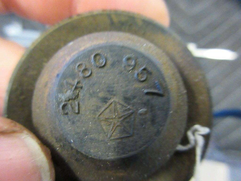

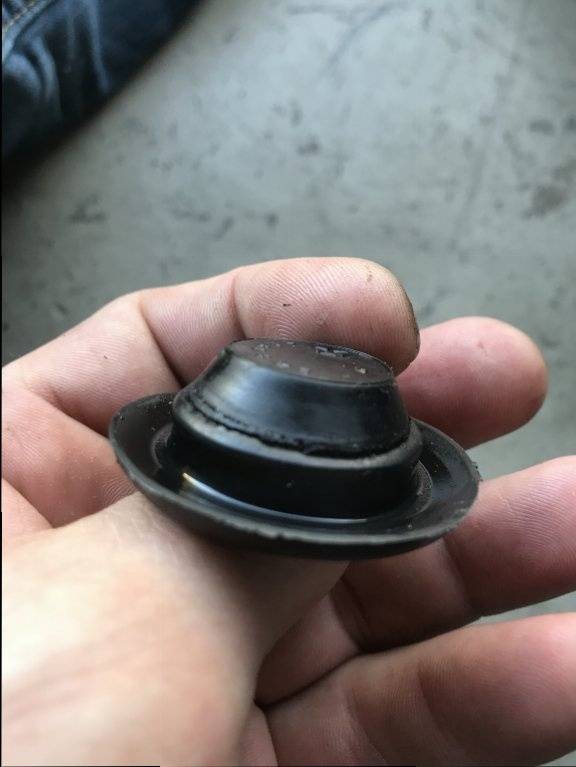

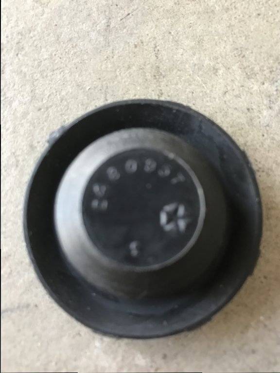

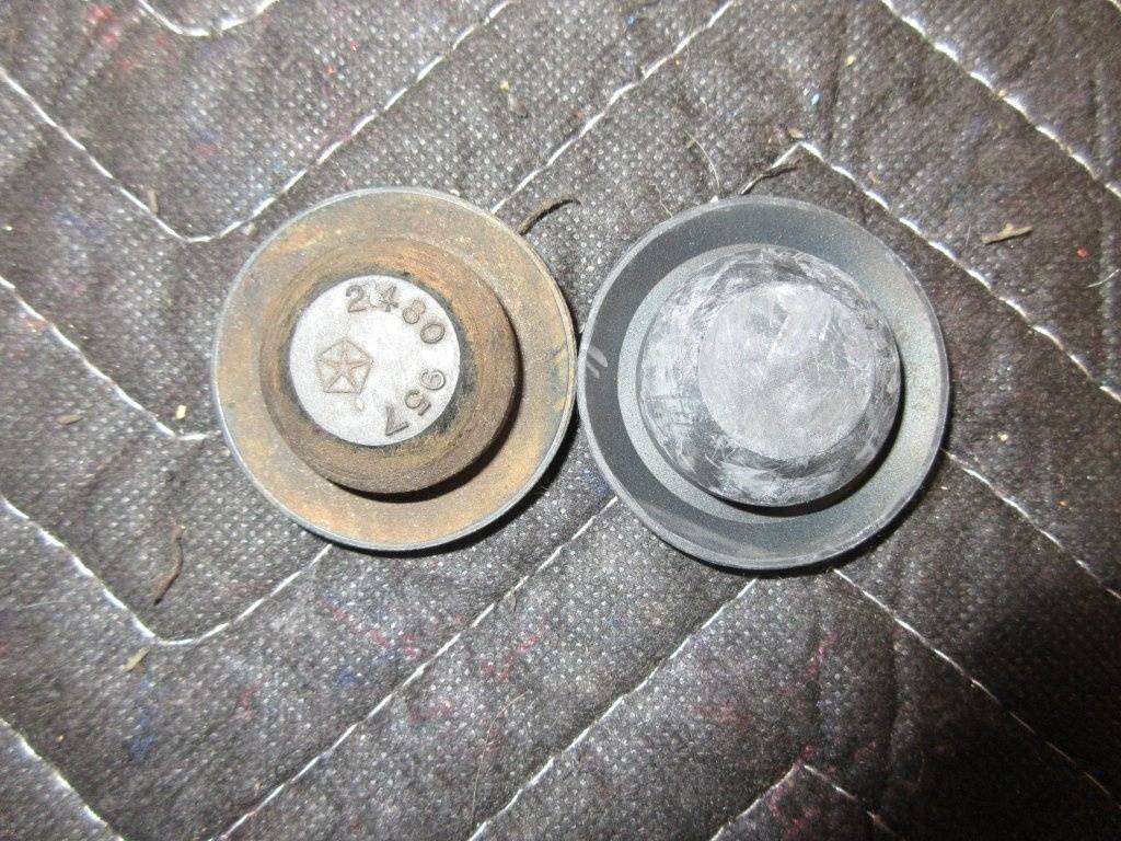

Here is an original plug with that same PN....Some difference in the measurement..
I will search for a pic of the plugs prior to removal...

Justin... that's a big difference in size for having the same part #

In the first post, all suggestions welcomed.

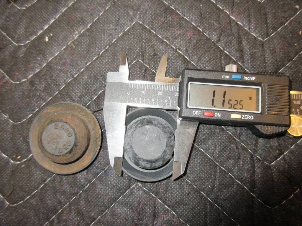

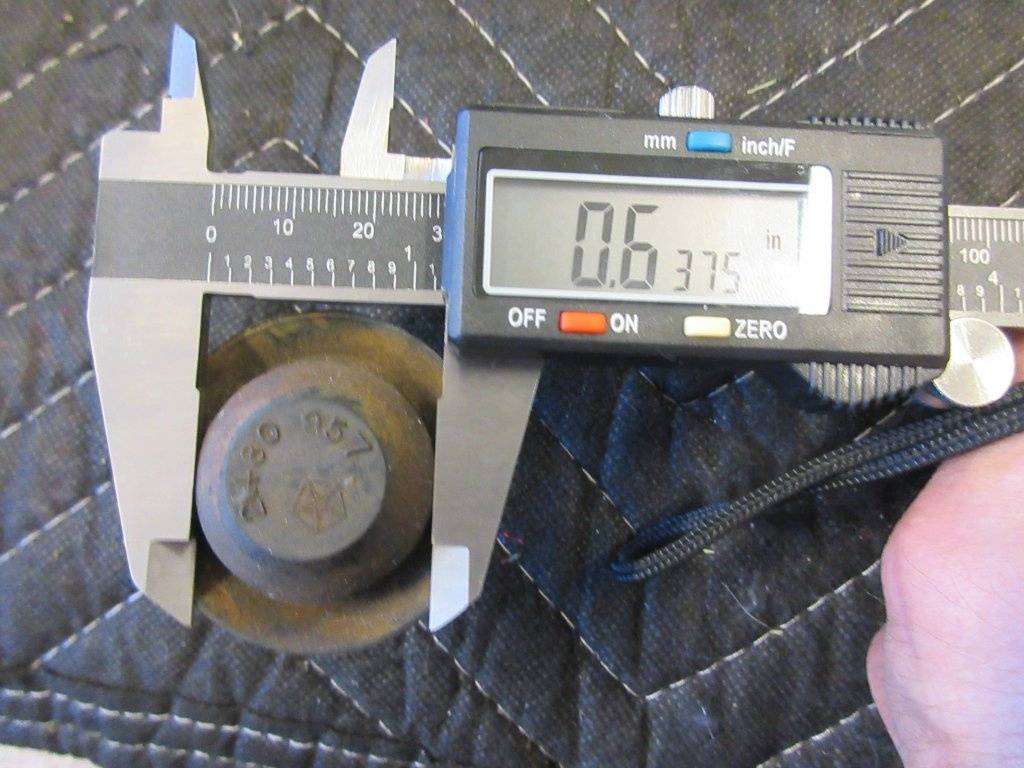

ws23jrt...thats incorrect...The issue is the repro market and the problems with them selecting universal plug for the kits they offer...
That OE plug I posted above came out of my 69 GTX and will get cleaned up to go back in...The originals are hard with age and I boil them and clean with sem vinyl prep and then back to black...That plug pictured was hard and boiled and is soft and pliable..I just now went out to the X and pressed in in by hand. It fits tight...
Comparison of the diameters of the OE and new....My build thread in the restoration section is comparing A LOT of old versus new...I am restoring my plugs and the ones that don't look like new I found original replacements...
View attachment 419162 View attachment 419163 View attachment 419164
Yep, that's the crap I bought
