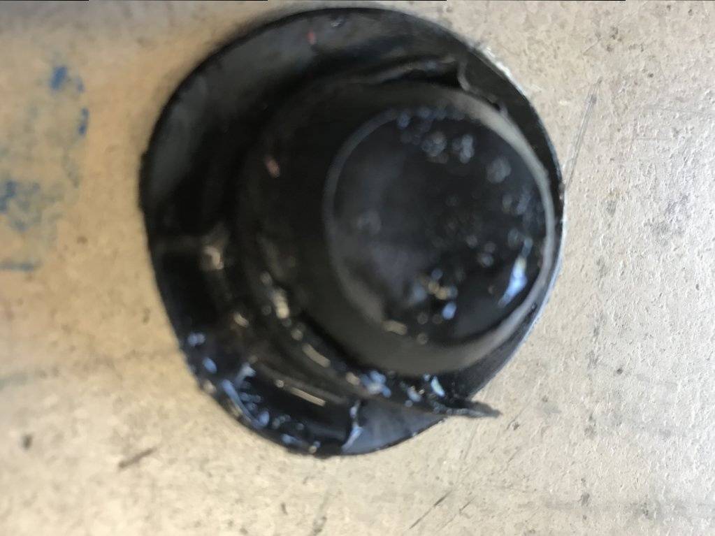

How the heck is this suppose to fit???
Thanks--I can still learn new stuff.--My task these days is retaining (and mixing) new information and fitting it with the old.:eek: I have no experience with aftermarket plugs.

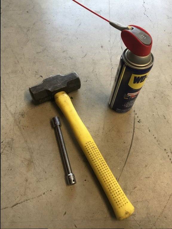

If I had known it was going to be this difficult, I would of used more care taking out the old ones
put some soap on it and drive it home!....... if the plug doesn't survive, it was junk anyway......... come on, make me proud!

DO NOT muff up those pans.....You can have my kit if you need it or I can put you in touch with a place that can pull some old plug(it will take awhile for them though)

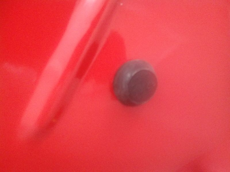

The plug you have pictured looks like a rubber plug? The ones you need are polypropylene.
Rubber goes behind the Seat...Look at my interior pic above....I have taken hundreds of these out..
They used rubber and poly, Originally!......The new ones are too big...

Justin is correct in that are just the wrong size. I'm very OCD on things like this but if I couldn't
get the correct size I would open the hole a bit
I thought about that too. Plugs are already damaged so I'll have to get more anyway. I thinks it's time to walk away before I do some real damage.
