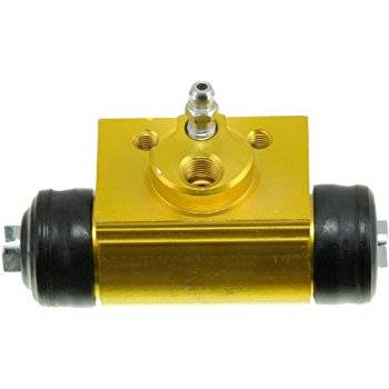

Good idea going with the aluminum MC....now does anyone make an aluminum wheel cylinder?
Yep.
And you can get that from where?
