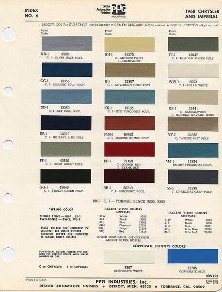

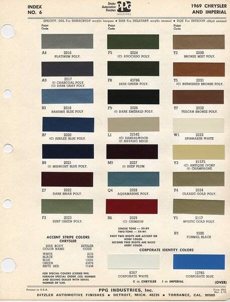

This doesn't answer your questions about the paint itself, but maybe the code, F5. Don't concern yourself so much with the NAME of the color, since Chrysler loved to be creative and change their names, sometimes, yearly, it seems. You'd just need to know the code and possibly the year.

Can someone please tell me which type of paint exactly has been applied on my car from the factory?
I know its enamel but is there only one type of enamel paint?
If there are multiple types of enamel paint:
Is the type applied on my car still available to purchase?
Your car had enamel paint applied from the factory, unlike General Motors which used lacquer in some factories up to the early 1980s. You shouldn't have problems with recoating with new enamel.
Does that mean any kind of enamel paint works as long as the color matches?
It's likely to be alkyd enamel, although it doesn't matter. You're spraying enamel over it so as long as you are have sprayed enamel before just do what you do.

I have a 1 1/2 gallons of 68 TT1 laquer available. I think it is close to F5, have to check
Don't spray lacquer over that unless you really crave adventure
