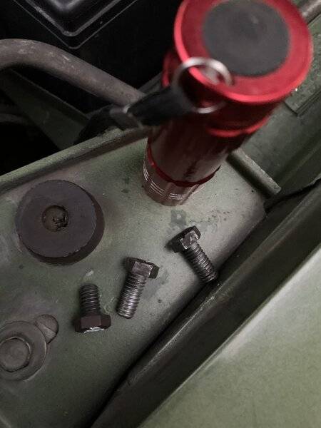

Question 2:
Today we replaced the fan clutch & fan which was a lousy job considering we did it with the radiator installed.
Unfortunately we lost one of the 4 bolts that bolt the fan clutch to the pulley.
I removed one of the bolts that bolted the old fan to the old fan clutch and its the same thread but shorter. (See picture)
Can i use the shorter bolt if i cant find the missing one?
Do you know what kind of screws these are? They require a 1/2" wrench.

For the missing fan clutch bolt i will use the shorter one if i cant find the one that we lost.
I think its long enough. But i need to get myself a set of sae nuts on bolts. I can't even replace a screw right now. :D
Michael - I usually make sure the valve cover is flat at the flange where the bolts are located. The sheet metal valve covers can bend in this area if over torqued. I clean the valve cover and adhear the cork gasket to the valve cover, placing the bolts in the holes for proper alignment. I prefer to use 3M weather strip adhesive for this. Once dry, I lightly apply wheel bearing grease to the side which will face the head. Then install the bolts and snug down lightly. Not sure what the torque is, I just try not to bend the valve cover flanges. They usually seal up without problem. Regarding your bolt delima, I cannot tell if the short bolt is long enough.
Ron
The bolts are 5/16"-18 and if you have at least 1/2" under head length they should work fine. Mine are a mix of 1/2" and longer..no problem.

And yes i think the bolt will be long enough. :)
