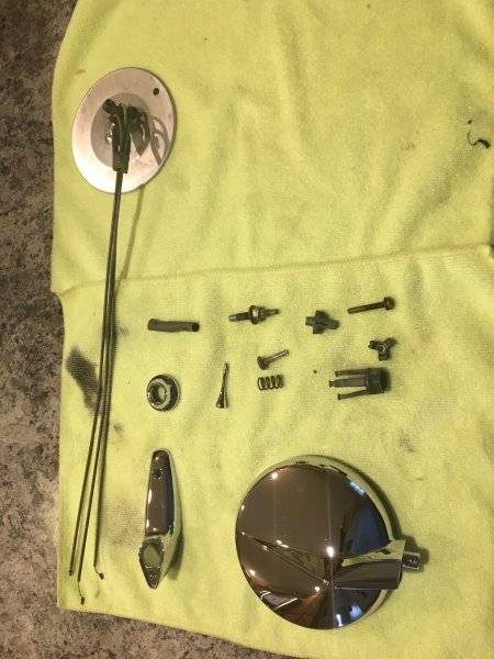

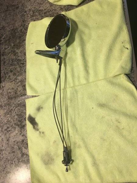

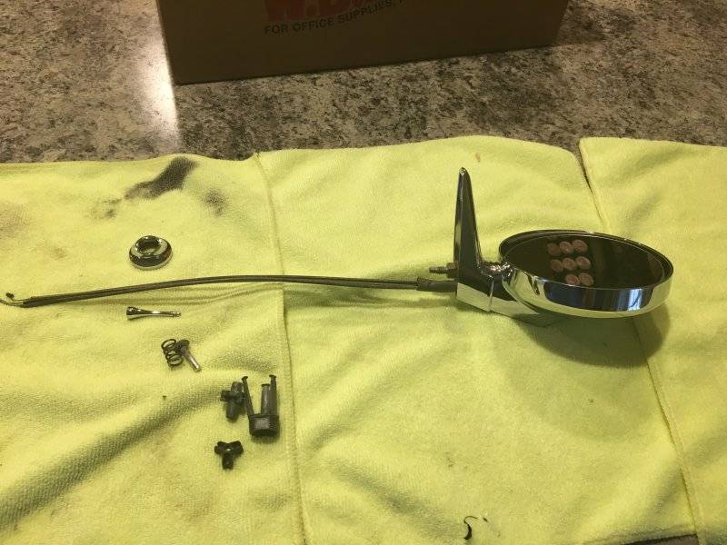

i need to get my original sideview mirror rechromed. Has mild pitting that i cannot get rid of. Does anyone know how to get the mirror out of the casing? i took it apart the best I could.

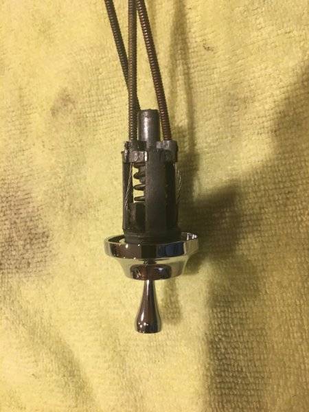

Good Morning Dave! Thank you for that info. That is what I tried to do. I can pull the cable out of the slot, but then it appears that some of the metal is stopping the end from pulling off near the base of the control knob. look at pic to see right below the threads where the cable head is. I will try to clean possible smeared metal in the way and clean better.
Dave, The sleeve that holds the cable end near the base of the thread is closed in so you cannot get the cable out. How did you get it out?
I did mine, 67 R/T. You have to pry the crimped fingers out on the adjuster. Be very careful, these were never meant to be serviced. I ended up putting some epoxy on the fingers when it all went back together. Mirror turned out great, I’m just afraid to adjust it using the stick.
Probably need to buy another mirror. I’ve never seen parts individually sold.
