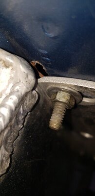

I looked for vin stampings on another 69 RR that is here right now. Just so I know where to look. On the core support, is this correct location? Next to the radiator? I felt around under the trunk weather strip lip all up and down the drivers side and could not feel any indents that could be a stamping. Not wanting to pull up weather strip on some one elses car.
It should be on the drivers' side of the radiator support. It could be on the top or backside, between the top tank and the support, upside down or not. It can be lightly stamped and hard to see.
