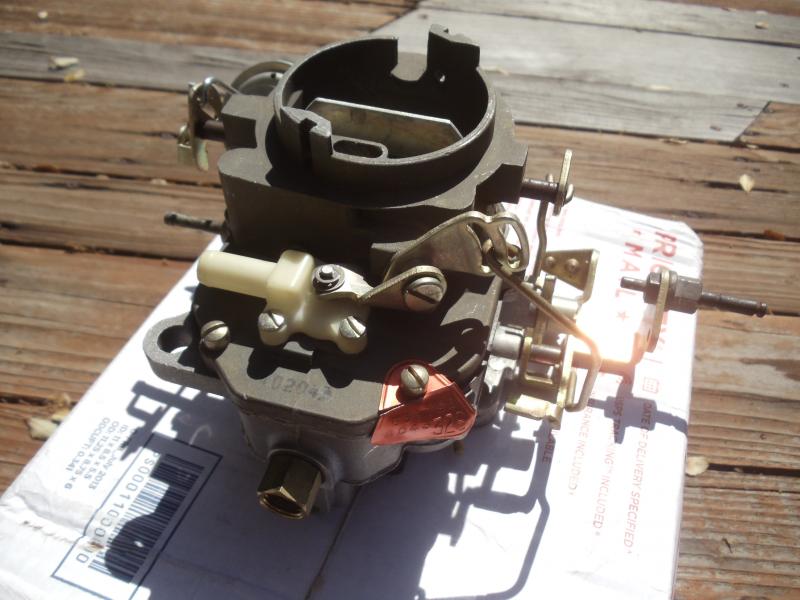

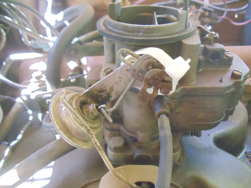

Posted this question on FABO also. Have a 1973 NOS Carter two-barrel for my 318 I am installing to replace the original 1972 Carter two-barrel. Need to use the old bracket/stud that the air cleaner wing nut screws onto. How on earth do I remove the bracket/stud from the old carb, seems to be affixed on there forever? Is it "spring" loaded, or bent to fit? I'm not as strong as I used to be. How do I get enough leverage to pop the darn thing off? Thank you.

I am talking about the solid rod that is bent in a "U" and hooks into the carb air horn. It is the top of that "bracket" that holds the air cleaner stud over the air horn. I am not talking about only the threaded part, I mean the entire bracket. Look at the first photo and you can see there is no way to screw on the air cleaner lid, no wing nut stud, no bracket to hold the wing nut stud. The lower foto (not a good view, sorry) shows the two "pedestals" that rise above the air horn that hold the bracket ("U" shaped round rod) for the wing nut stud.
the u shaped bar is kinda spring loaded into the air horn.the fist pic shows the small hole the bottom of that bar fits into(sun lite is shining through it).sides of the u go into the grooves on the air horn.
Hey Dibbons, the hoop, or 'U' shaped part has a bit of spring tension so it stays in place once installed. On your carb, you should be able to get a narrow flat blade down from the top into the slot above the hole on each side of the hoop and simply pry gently until it comes out of the hole.
