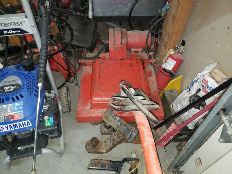

I still have the Tune in that I used at the first Ford dealer I worked at in 83. I have been a service rep for Hunter for 25 years now.
Finger on the drivers fender, antenna on the passenger side. I think I balanced the tires on 2/3s of the cars in that town. Everyone wanted them spun as fast as possible. I was told a balanced tire is balanced no matter how fast it was spun. We never spun them very fast because of the safety issues. They clamping device were known to come off of chrome wheels. The last time it came off the wheel, the dealership owner said toss that dam thing in the trash. I asked if I could have it so I kept it.
