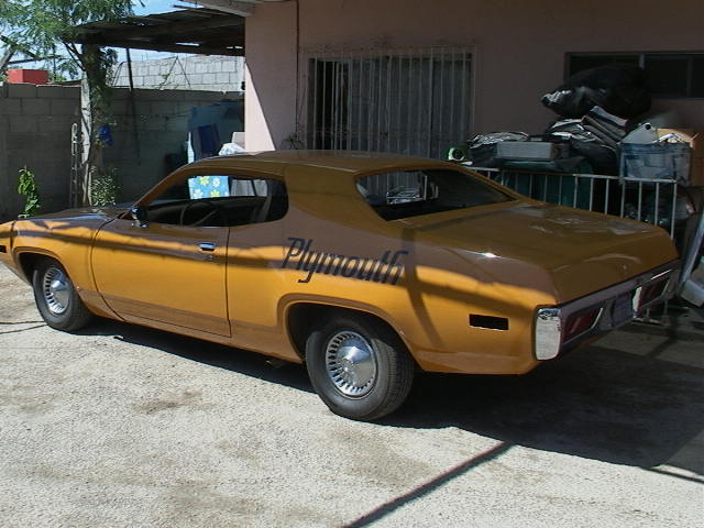

Would like to experiment with the Moper factory hydraulic camshaft on my currect project: This is the 340 4-Speed {1968} camshaft with
* .445"/.456" Lift ~ 276*/284* Duration ~ 52* Overlap.
In my "prime" I always used solid lifter camshafts. I guess, now its time to "downgrade" to a hydraulic.
I wonder what the RPM limit of this 1968 camshaft would be with the factory style valve springs? Could I safely spin it above the standard 5500 RPM redline? (Probably use a stock manifold and 72 thermoquad). Maybe there wouldn't be any reason to reach for a higher horsepower peak. Just wondering for now and not sure what all the talk is about regarding lifter pump-up, valve float, etc.
