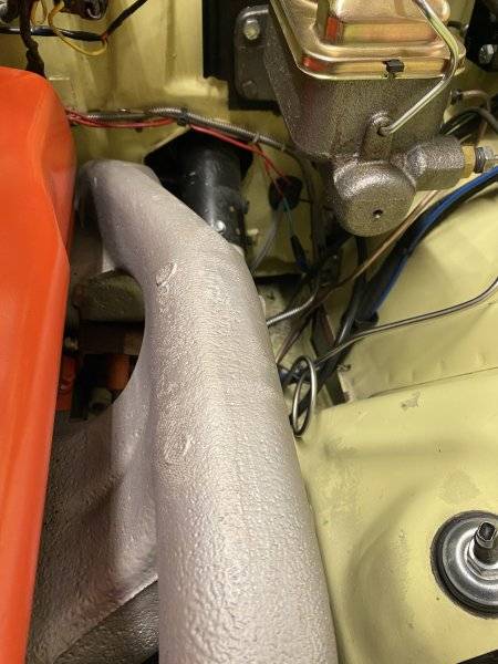

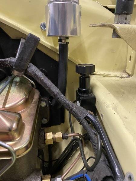

Here is video of what else is involved installing this kit with the pedals on the car. In the pedal assembly, I have circled in red, what needs to be removed from an original 4 speed pedal assembly, as their video focuses on an automatic pedal assembly. I have also attached some pics of the final install. Fairly straight forward, and their customer service is awesome.
