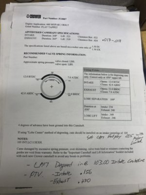

I went the other direction with mine. Not saying it’s right or wrong, just what I did. The other posters here have WAY more experience than I.
I used a custom grind Crower solid flat tappet with their EDM lifters.
I didn’t want to spend the extra money for the roller cam and the extra money on good roller lifters.
I bought a set of used Isky ductile iron rockers from a local friend and sourced some shafts (banana grooved) and hold down hardware from RAS. We had to put the arms in a lathe to take some width off them.
My goals were similar to yours, and I’m happy with my outcome

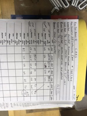

Here is the cam I bought and here are the flow numbers from my ported 906 heads:
