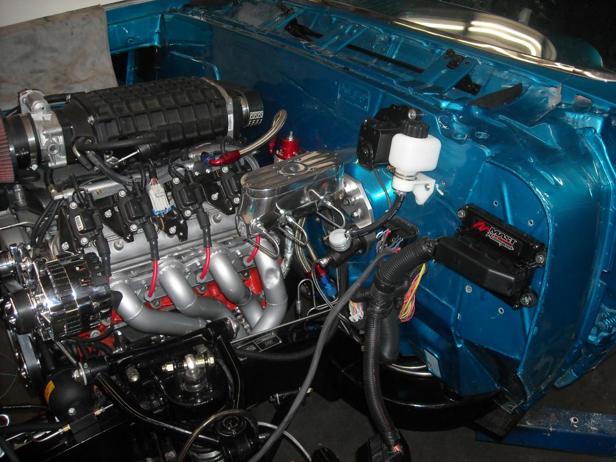

I've been installing electric boosted brake systems lately. It's a smaller set up on the firewall and there is an accumulator on the remote mounted electric pump that will give you about 25 pumps before you lose boost if the power fails.
I don't know how well this pic will work, but if you look just in front of the control arm, you can see the accumulator for the brakes. The electric pump is just forward and below.

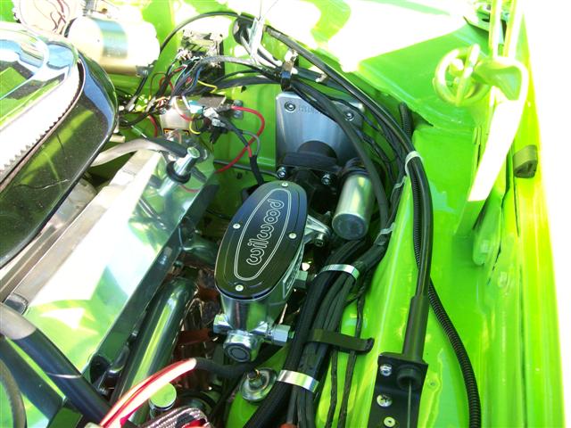

I have one installed on my '69 Charger coupled with a Wilwood MC, in conjunction with a 4-wheel Wilwood disc system. I converted from a manual 4-wheel SSBC system.
Performance is night & day. Really a positive feeling pedal.
Also, despite the previous poster, if you lose power steering there is a reserve that will allow about 2-3 stops with power. See that little canister? That is a nitrogen reserve tank that holds pressure in case you lose PS.
I got the setup from RMS (Reilly Motorsports). It installed easily, and came with everything. Brake system came from Prodigy Customs, a Wilwood distributor.

I got mine from Reilly Motorsports (RMS). I think it was around $600 without the M/C. I already had the M/C.
Hardest part about the installation was the hard lines from the prop valve to the M/C. The car had manual brakes prior to the Hydroboost with a Mopar/stock type M/C from SSBC. The Hydroboost placed the M/C further up. Also, the fittings from the Wilwood M/C did not match up to the ones on my hard lines.
I mocked some up using stiff coat hanger wire, & sent them off to Fine Lines where they bent up new ones using my templates. Got them back, & they fit like a glove.
