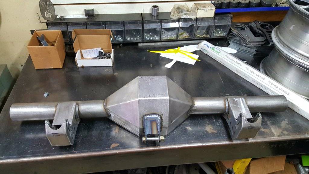

What would you like to know? It's the speedtech arm but they don't make a full kit for Mopar so going to fab the trailing arms and mounts. I have a T56 so my new tranny cross member will be modified with the receiver. My trailing arm/ coilover mounts are already made with my new fab 8 3/4

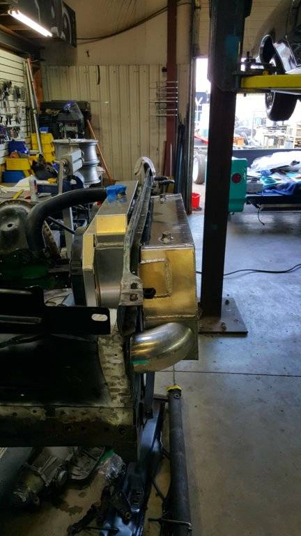

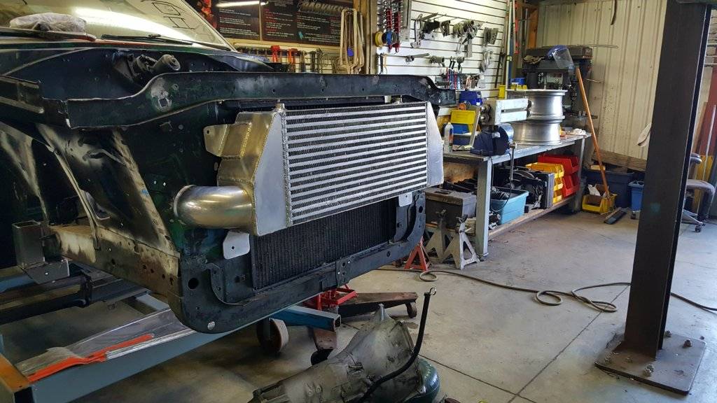

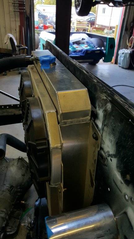

Here's the frustrating part for me I think I'm going to have to sell my baddass Wizard Cooling Rad and look for something that I can do a dual fan setup on maybe with a side mount tank.
The Procharger leaves things to tight at the back and the chunky intercooler Doesn't leave me any room to go forward.
I'm tired of selling perfectly good pieces that I paid a lot of money for and work extremely well but this i got myself into This! Lol
It's a 22" rad with 1.25" upgraded dual cores (holds as much coolant as a 4 core) and an integrated shroud with 4 9" SPAL fans. Really nice piece

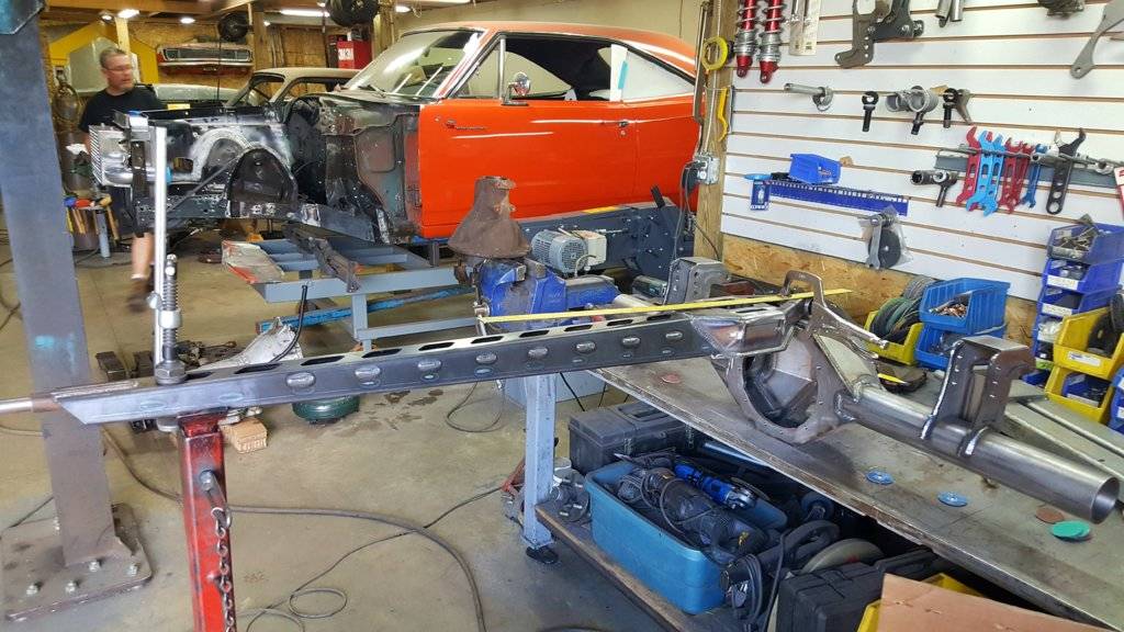

Started the layout for the torque arm. Will use Heim Joints to mount like the one pictured and allow the pinion angle to be adjusted. Just waiting on a few parts. Have the material for the trailing arms and to make an adjustable Panhard so we should be able to tackle this soon. The bracket is welded up on the bottom side and gusseted but may add some speedholes for prosperity!
