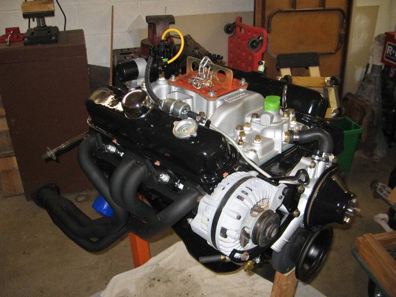

i have a new set of headers that were for a 318 duster will they work on this car
Probably but there is only one way to know for sure.
Any idea who made the headers ? In the photo below are the Jegs/Summit cheapies on a 1970 318.
I installed them on my 63 Belvedere without a problem. They fit many Mopars A,B,F and others.
If they look like these then they will fit.As you can see the driver side header the centerlink crosses thru
and the pipes hang below.
We did a header install like this many years ago without a problem, but don't recall the manufacturer. I'm thinking Blackjack, we did a few of those.
