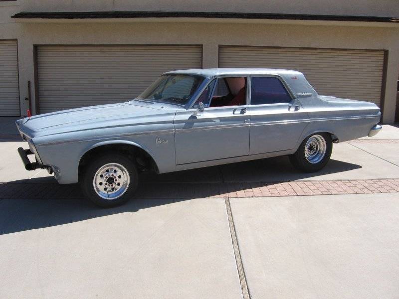

Sure, This is a old photo of my 63 with the Summit brand. Front end raised about 2'' from stock.
The front tires were only 25 1/2'' tall.I was going for a Gasser look. Sold the wheels and now run 27'' front tire and lowered the car back down to compensate. I have a few speed bumps in the industrial park where my shop is and have good clearance.

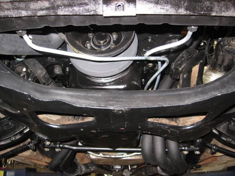

So the Summit headers go over the steering linkage, not under it?
Actually on the driver side header the drag link goes thru the tubes 3 going under and 1 above. Repost of photo showing the driver side header.
